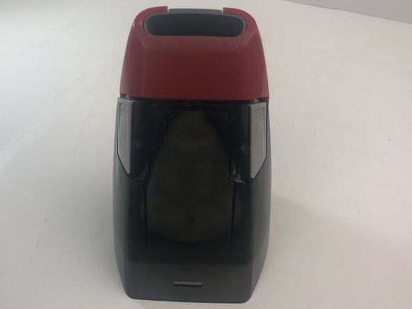

If your Dirt Devil Gator (Model Number: BD10100) isn’t creating suction, picking up debris, or functioning properly, you may need to replace the filter. Follow this guide to clean/replace the filter on your device.
However before using this guide, you may not need to fully replace the filter, just clean it. A clogged air filter is a simple problem with a quick fix to get you started vacuuming again quickly!
The filter on the Dirt Devil Gator helps collect dirt and debris from the ground into your vacuum. A clogged filter will not pick up dirt or hold on to already picked up debris. If the filter is destroyed, it will need a replacement.
Before beginning, make sure to power off your device completely and disconnect from any external power source.
    1. Dirt Devil Gator Filter Replacement, Filter: crwdns2935265:01crwdnd2935265:01crwdnd2935265:01crwdne2935265:0

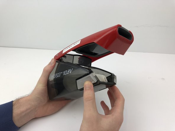

      • To get to the filter, press the button on the top of the vacuum to split your device in two.
    2. Dirt Devil Gator Filter Replacement: crwdns2935265:02crwdnd2935265:01crwdnd2935265:03crwdne2935265:0 Dirt Devil Gator Filter Replacement: crwdns2935265:02crwdnd2935265:02crwdnd2935265:03crwdne2935265:0 Dirt Devil Gator Filter Replacement: crwdns2935265:02crwdnd2935265:03crwdnd2935265:03crwdne2935265:0
      • Remove your Dirt Devil Gator into its two components by pulling apart.
    3. Dirt Devil Gator Filter Replacement: crwdns2935265:03crwdnd2935265:01crwdnd2935265:02crwdne2935265:0 Dirt Devil Gator Filter Replacement: crwdns2935265:03crwdnd2935265:02crwdnd2935265:02crwdne2935265:0
      • Turn over the front half of the device.
    4. Dirt Devil Gator Filter Replacement: crwdns2935265:04crwdnd2935265:01crwdnd2935265:03crwdne2935265:0 Dirt Devil Gator Filter Replacement: crwdns2935265:04crwdnd2935265:02crwdnd2935265:03crwdne2935265:0 Dirt Devil Gator Filter Replacement: crwdns2935265:04crwdnd2935265:03crwdnd2935265:03crwdne2935265:0
      • Press the two grey buttons on either side of the filter chamber inwards to release the chamber.
    5. Dirt Devil Gator Filter Replacement: crwdns2935265:05crwdnd2935265:01crwdnd2935265:01crwdne2935265:0
      • Remove all debris and obstructions around the filter itself.
      • Remove from the filter chamber by pulling out the filter.
    6. Dirt Devil Gator Filter Replacement: crwdns2935265:06crwdnd2935265:01crwdnd2935265:01crwdne2935265:0
      • Replace it with a new or restored filter by placing it back in the filter chamber.
