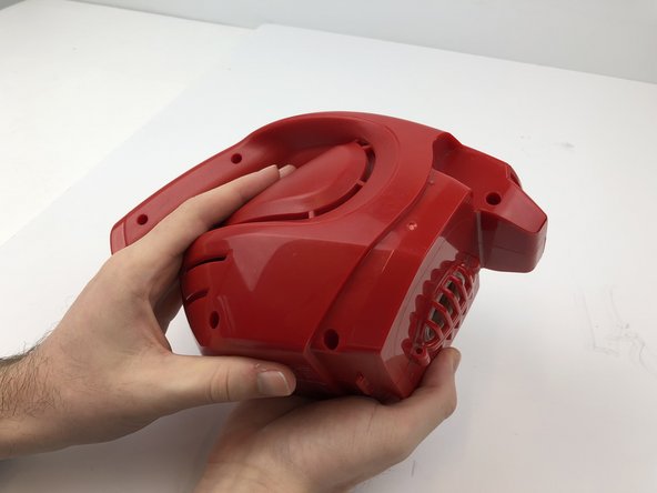

    • Press the button found in the middle of the vacuum downwards. Then, separate the front from the back of the device by gently pulling apart.

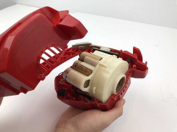

    • Separate the front and the back and set the front aside.
    • Pull on the back of the vacuum, there should not be too much resistance when pulling it out.

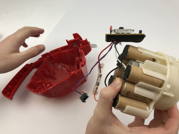

    • Unscrew each individual 13 mm screws from the vacuum with a micro screwdriver.
    • Once unscrewed, pull the case of the Dirt Devil Gator apart.

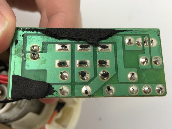

    • Remove the grey switch from the top of the device by pulling gently. Then, remove the complete motor by also pulling gently out of socket.
    • Take note that the circuit is at the top of the vacuum and everything must be removed

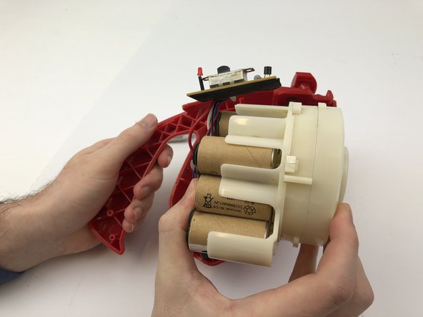

  5. Dirt Devil Gator Circuit Board Replacement: crwdns2935265:05crwdnd2935265:01crwdnd2935265:01crwdne2935265:0
    • Remove the motor from your Dirt Devil Gator exterior by slightly pulling out the white motor.
    • Includes: batteries, motor, circuit board, wires
