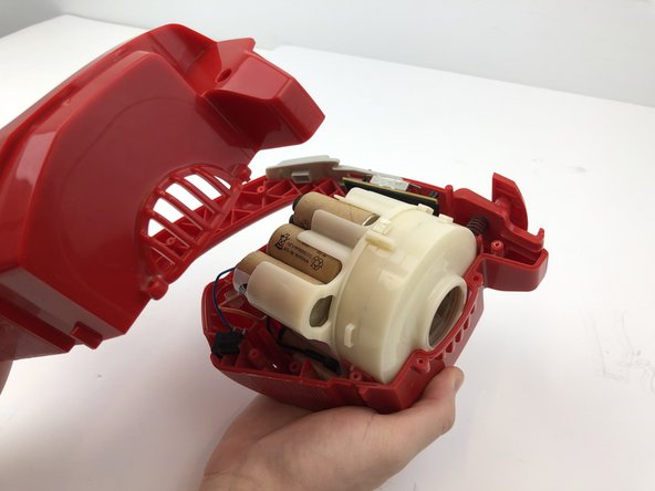

    • Press the button on the middle of the vacuum by pushing down on it and pulling the device apart.
  2. Dirt Devil Gator Charger Replacement: crwdns2935265:02crwdnd2935265:01crwdnd2935265:03crwdne2935265:0 Dirt Devil Gator Charger Replacement: crwdns2935265:02crwdnd2935265:02crwdnd2935265:03crwdne2935265:0 Dirt Devil Gator Charger Replacement: crwdns2935265:02crwdnd2935265:03crwdnd2935265:03crwdne2935265:0
    • Separate the front and back half of the vacuum.
    • Pull on the back of the vacuum, there should not be too much resistance when pulling it out.
  3. Dirt Devil Gator Charger Replacement: crwdns2935265:03crwdnd2935265:01crwdnd2935265:03crwdne2935265:0 Dirt Devil Gator Charger Replacement: crwdns2935265:03crwdnd2935265:02crwdnd2935265:03crwdne2935265:0 Dirt Devil Gator Charger Replacement: crwdns2935265:03crwdnd2935265:03crwdnd2935265:03crwdne2935265:0
    • Unscrew each individual 13 mm screws with a micro screwdriver from the vacuum.
    • After unscrewing all of the screws, firmly pull on the side of the vacuum to separate the exterior.

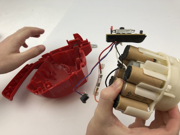

  4. Dirt Devil Gator Charger Replacement: crwdns2935265:04crwdnd2935265:01crwdnd2935265:03crwdne2935265:0 Dirt Devil Gator Charger Replacement: crwdns2935265:04crwdnd2935265:02crwdnd2935265:03crwdne2935265:0 Dirt Devil Gator Charger Replacement: crwdns2935265:04crwdnd2935265:03crwdnd2935265:03crwdne2935265:0
    • Pull out the grey switch and circuit board from its slot in the red case.
    • Remove all of the wires from the vacuum to where only the battery and wires are left.
    • Firmly pull out the battery and motor assembly. The circuit board and wires will remain attached.
