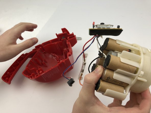

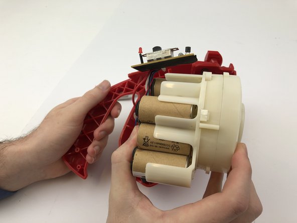

      • Pull out the grey switch and circuit board from its slot in the red case.
      • Remove all of the wires from the vacuum to where only the battery and wires are left.
      • Firmly pull out the battery and motor assembly. The circuit board and wires will remain attached.
    5. Dirt Devil Gator Battery Replacement: crwdns2935265:05crwdnd2935265:01crwdnd2935265:02crwdne2935265:0 Dirt Devil Gator Battery Replacement: crwdns2935265:05crwdnd2935265:02crwdnd2935265:02crwdne2935265:0
      • Cut the white and black wires with wire cutters to disconnect battery from the motor. Follow this guide to desolder!
      • Remove the tan couplings from their white sockets and replace with new batteries.
      • If the battery is torn or has battery acid around it, do not touch the battery. Safely dispose the battery. If come into contact with acid, wash hands thoroughly.

Judging by the pictures, the battery seems to be comprised of standard sub-c NiCd cells.
You would probably also be able to use NiMh cells, which would grant you a little more runtime and can be bought pretty much everywhere.
