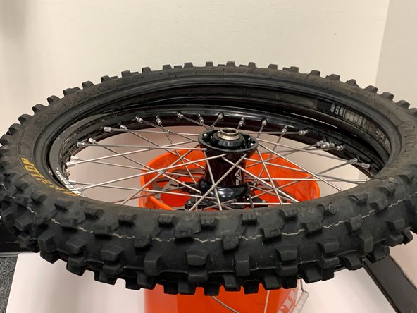

    • Remove the valve stem cap, then let the air out of the tube by pushing in on the valve end with either a fingernail or the open end of your smaller wrench.
  2. Dirt Bike Tire Spoke Replacement: crwdns2935265:02crwdnd2935265:01crwdnd2935265:03crwdne2935265:0 Dirt Bike Tire Spoke Replacement: crwdns2935265:02crwdnd2935265:02crwdnd2935265:03crwdne2935265:0 Dirt Bike Tire Spoke Replacement: crwdns2935265:02crwdnd2935265:03crwdnd2935265:03crwdne2935265:0
    • Use a 12 mm wrench to loosen the rim lock nut as far as possible without removing it.
    • Push down on the edges of the tire to break the bead and create a gap between the rim and tire. Work around the entire tire until the tire is loose from the rim.
    • Flip the tire over, then repeat the process of breaking the bead.

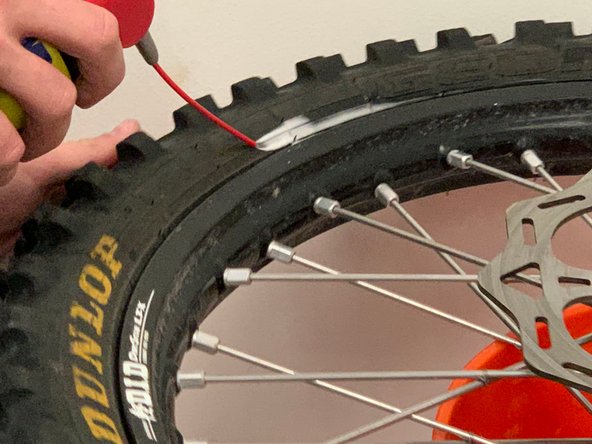

    • Spray lubricant around the edge of the tire where it meets the rim. Do this all the way around, then flip and repeat on the other side.

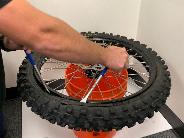

  4. Dirt Bike Tire Spoke Replacement: crwdns2935265:04crwdnd2935265:01crwdnd2935265:02crwdne2935265:0 Dirt Bike Tire Spoke Replacement: crwdns2935265:04crwdnd2935265:02crwdnd2935265:02crwdne2935265:0

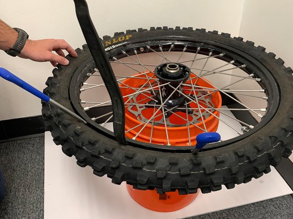

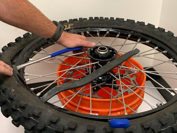

    • Push down on the tire to one side of rim lock to create a gap, then insert one of the tire spoons with the curved edge facing down. Be sure it makes it over the lip of the tire that is in the rim.
    • About 6 inches away, insert the tire iron, and then the other spoon in the same manner.

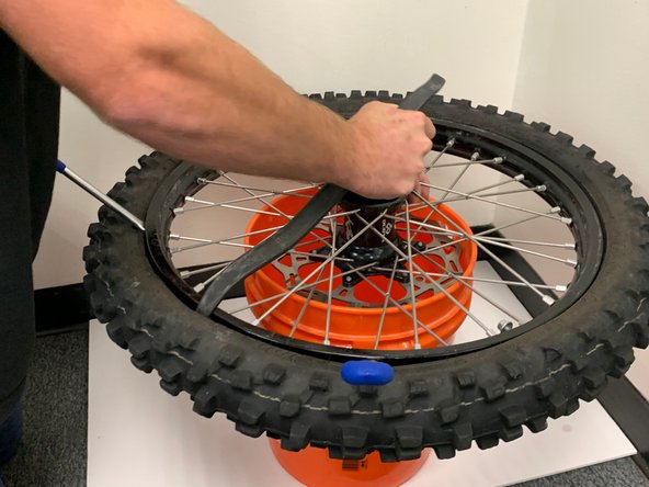

  5. Dirt Bike Tire Spoke Replacement: crwdns2935265:05crwdnd2935265:01crwdnd2935265:03crwdne2935265:0 Dirt Bike Tire Spoke Replacement: crwdns2935265:05crwdnd2935265:02crwdnd2935265:03crwdne2935265:0 Dirt Bike Tire Spoke Replacement: crwdns2935265:05crwdnd2935265:03crwdnd2935265:03crwdne2935265:0

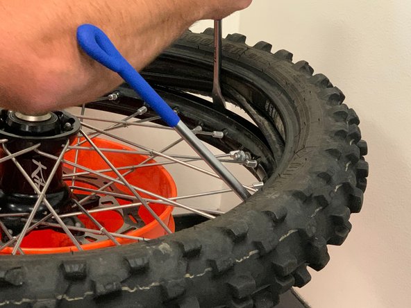

    • With all 3 tools inserted into the rim, grasp the tire iron and push in and over towards the center of the rim. Continue holding it down and repeat with the spoon to the side of it away from the rim lock.
    • This begins the process of bringing the inside edge of the tire out over the rim.

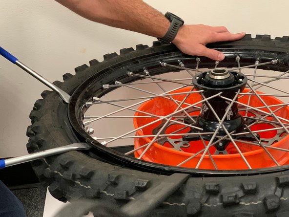

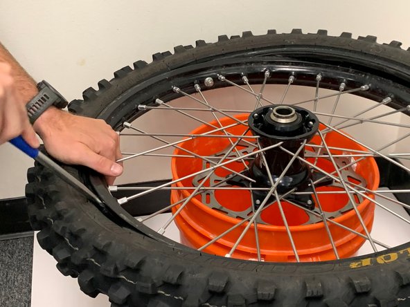

  6. Dirt Bike Tire Spoke Replacement: crwdns2935265:06crwdnd2935265:01crwdnd2935265:03crwdne2935265:0 Dirt Bike Tire Spoke Replacement: crwdns2935265:06crwdnd2935265:02crwdnd2935265:03crwdne2935265:0 Dirt Bike Tire Spoke Replacement: crwdns2935265:06crwdnd2935265:03crwdnd2935265:03crwdne2935265:0
    • Leave the spoon nearest the rim lock in position to prevent the tire from slipping back over the rim.
    • Use one spoon and, inserting it every 6-8 inches, work around the tire levering it over the edge of the rim.
    • Once the tire is completely over the rim, flip the tire over and repeat Steps 5 and 6 to bring the tire over the rim on both sides.

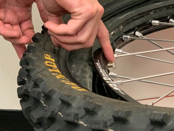

    • Remove the valve stem nut.
    • Place the nut somewhere it will not be lost.

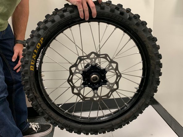

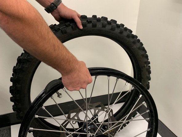

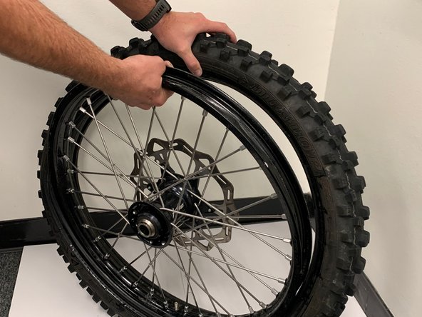

    • Stand the tire up, resting it on the ground.
    • Grip the tire with one hand and the rim with the other.
    • Push the tire away from you while pulling the rim in towards you. This may require some force.
    • Pull the rim out of the tire, and set the tire aside for later.

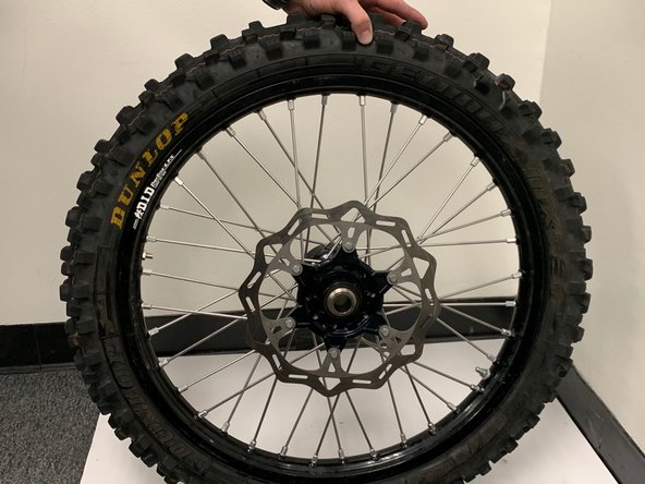

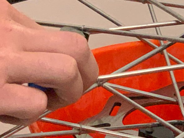

    • Set the rim back on the stand.
    • Identify the spoke to be replaced.

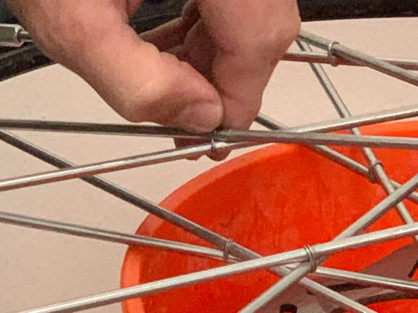

    • If necessary, use snips to cut the safety wire on the spokes, and remove.
  10. Dirt Bike Tire Spoke Replacement: crwdns2935265:010crwdnd2935265:01crwdnd2935265:03crwdne2935265:0 Dirt Bike Tire Spoke Replacement: crwdns2935265:010crwdnd2935265:02crwdnd2935265:03crwdne2935265:0 Dirt Bike Tire Spoke Replacement: crwdns2935265:010crwdnd2935265:03crwdnd2935265:03crwdne2935265:0

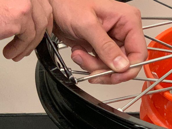

    • If necessary, use the utility knife to cut a small hole in the rim strip behind the spoke nipple.
    • Loosen the spoke nipple using a 7 mm wrench.
    • Remove the spoke.
    • Replace the spoke.
    • Installation is the reverse of removal. Tighten the new spoke into the nipple.
    • Be sure the spoke is laced into the wheel in the same way as the one that was removed. Make sure it goes under or over the one next to it as necessary. Look at other sets of spokes on the wheel to determine the correct orientation.

    • Flip the tire over, and insert a spoon on either side of the rim lock.
    • Pull on the rim lock nut so it goes in towards the center as far as possible.
    • Use the spoons to lever the tire out and over the rim lock, then push the rim lock nut the other way so the tire drops between the rim lock and the rim.
