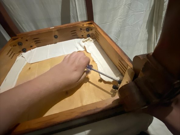

    • Flip the chair upside down to reveal bolts
    • unscrew the bolts off the base of the chair
    • Keep the bolts in a safe place to prevent losing them as you will need them to out the chair back together

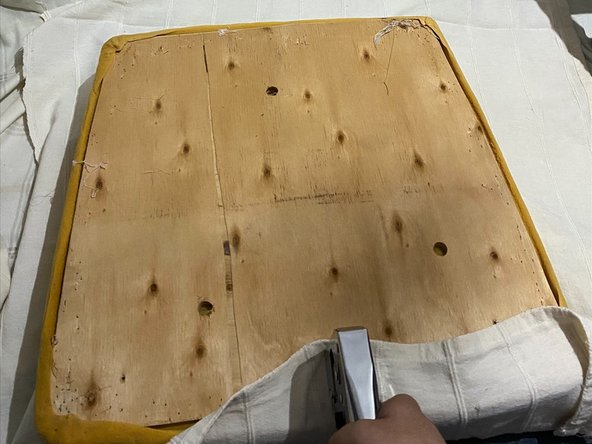

  2. Dinning Chair Seat Cushion and Upholstery Replacement: crwdns2935265:02crwdnd2935265:01crwdnd2935265:02crwdne2935265:0 Dinning Chair Seat Cushion and Upholstery Replacement: crwdns2935265:02crwdnd2935265:02crwdnd2935265:02crwdne2935265:0
    • The staples can be dangerous so proceed with caution while removing them.
    • Remove the staples holding the upholstery fabric in place.
    • Dispose the staples that were removed

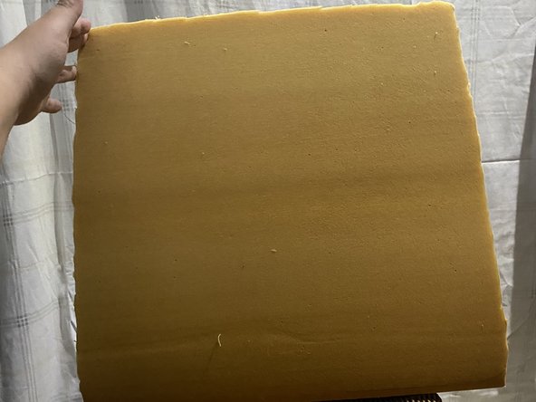

  3. Dinning Chair Seat Cushion and Upholstery Replacement: crwdns2935265:03crwdnd2935265:01crwdnd2935265:02crwdne2935265:0 Dinning Chair Seat Cushion and Upholstery Replacement: crwdns2935265:03crwdnd2935265:02crwdnd2935265:02crwdne2935265:0
    • With a measuring tape and or ruler, measure the outline of the base of the seat
    • With a pen, create the outline of the base of the seat
    • Cut with scissors or with a blade along the outline you drew

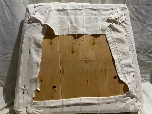

  4. Dinning Chair Seat Cushion and Upholstery Replacement: crwdns2935265:04crwdnd2935265:01crwdnd2935265:03crwdne2935265:0 Dinning Chair Seat Cushion and Upholstery Replacement: crwdns2935265:04crwdnd2935265:02crwdnd2935265:03crwdne2935265:0 Dinning Chair Seat Cushion and Upholstery Replacement: crwdns2935265:04crwdnd2935265:03crwdnd2935265:03crwdne2935265:0
    • Staple gun can be dangerous if it’s not safely used
    • Grab your new upholstery fabric and cover the foam down to the bottom of the wooden base
    • staple the fabric to the base and make sure it stays on tight

    • Assemble the chair back together with the bolts previously removed

You skipped a lot of steps that would have been helpful. Like step 3 measure and cut what? It looks like foam for the seat. How do I know whether I need to replace the foam or just add more foam? What type of foam do I use? Should I place a filler on top of the foam? What about the fabric for step 4? What type of fabric do I need? How do I figure out how much fabric to use? What steps do I use to staple the fabric in place so it's tight and will stay put?
Good tutorial if someone just needs a refresher on the steps. But there's no way a first timer is following this and coming out with anything but frustration.
