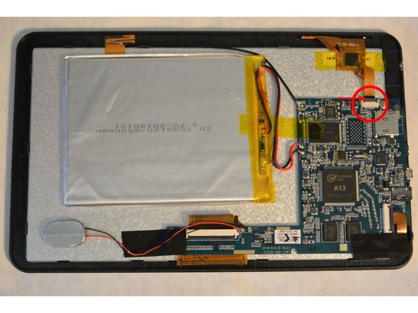

  4. Digital2 D2-912 Motherboard Replacement: crwdns2935265:04crwdnd2935265:01crwdnd2935265:01crwdne2935265:0
    • Use the Phillips #00 screwdriver to remove the three screws from motherboard.
  5. Digital2 D2-912 Motherboard Replacement: crwdns2935265:05crwdnd2935265:01crwdnd2935265:02crwdne2935265:0 Digital2 D2-912 Motherboard Replacement: crwdns2935265:05crwdnd2935265:02crwdnd2935265:02crwdne2935265:0
    • Detach the capacitive touch controller from the motherboard.
    • Carefully pry the narrow black connector upward to release the ribbon.
    • Remove the ribbon from the connector.
