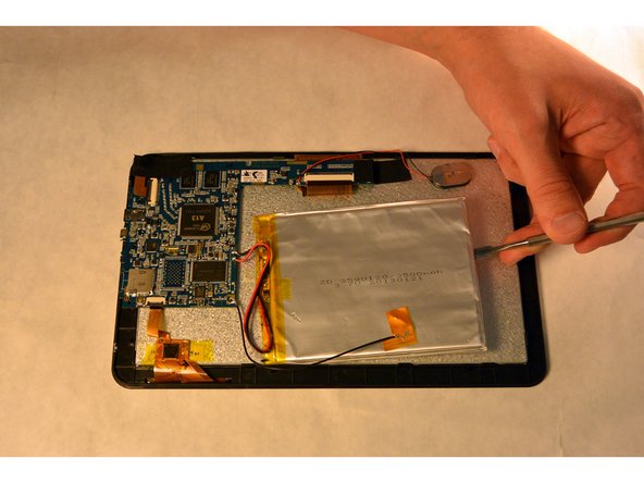

  3. Digital2 D2-912 Battery Replacement, Battery: crwdns2935265:03crwdnd2935265:01crwdnd2935265:02crwdne2935265:0 Digital2 D2-912 Battery Replacement, Battery: crwdns2935265:03crwdnd2935265:02crwdnd2935265:02crwdne2935265:0
    • The battery to be removed is shown with the red box in the photo.
    • Gently remove the battery from the tablet by sliding the metal spudger under the battery.
    • There is glue holding the battery in place, so this step requires some finesse.
    • At this point, your battery should still be attached to the tablet by a red and black wire.
  4. Digital2 D2-912 Battery Replacement: crwdns2935265:04crwdnd2935265:01crwdnd2935265:01crwdne2935265:0
    Desoldering Pump
    $3.99
    • Take note of which wire goes where (black wire below red wire in photo).
    • In gold writing, 'bat+' indicates the positive terminal (location of red wire), and 'bat-' indicates the negative terminal (location of black wire).
    • To remove the wires from their terminals, use a soldering iron and a solder sucker.
    • Refer to the ifixit solder guide to learn more about how to solder.
    • Attach the black (negative) and red (positive) wires of the new/replacement batteryrespectively to their terminals by soldering them.
    • Position the battery in it's original location, secure with glue.
