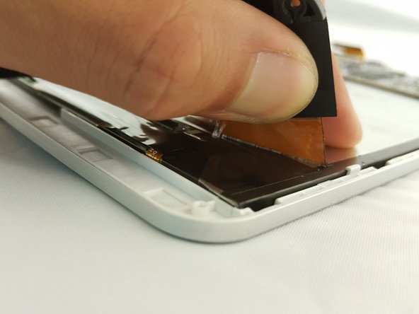

  4. Digital2 D2-861G Speaker Replacement: crwdns2935265:04crwdnd2935265:01crwdnd2935265:02crwdne2935265:0 Digital2 D2-861G Speaker Replacement: crwdns2935265:04crwdnd2935265:02crwdnd2935265:02crwdne2935265:0
    • Make sure to not bend or puncture the battery when removing it.
    • Locate the bundled cable connector and disconnect it by simply pulling it gently with your hands or using a spudger.
    • Use prying tools to carefully break the adhesive under the battery
