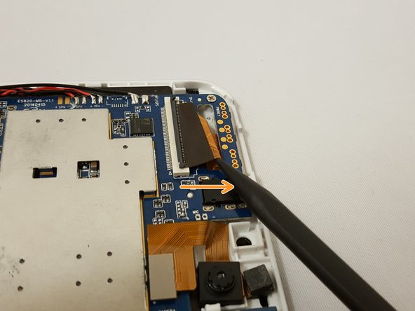

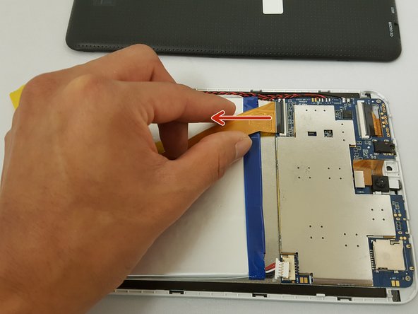

    • Locate the gold colored ZIF (Zero insertion force) connector and disconnect it from the motherboard.
    • To disconnect the ZIF connector, go under the black tab and lift up. Then pull the connector out.
    • Locate the bundled cable connector and disconnect it by simply pulling it gently or using a spudger.
    • Disconnecting the bundled cable connector helps avoid short circuiting anything on the device.

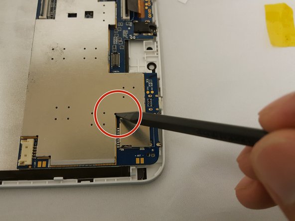

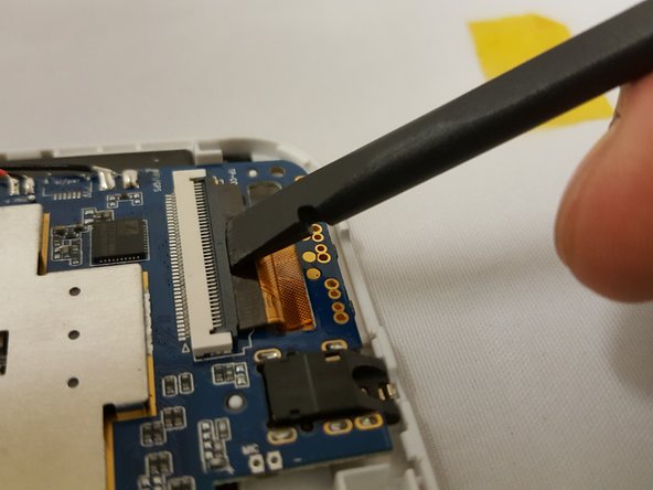

    • Make sure to have your magnetic board to hold your screws.
    • Remove two 3.51mm screws that are located on the top corners with your Phillips #00 screwdriver.
    • Next, unplug the ZIF connector by going under the black tab and simply lift up.
    • Slide the connector out with the pointed side of the spudger.

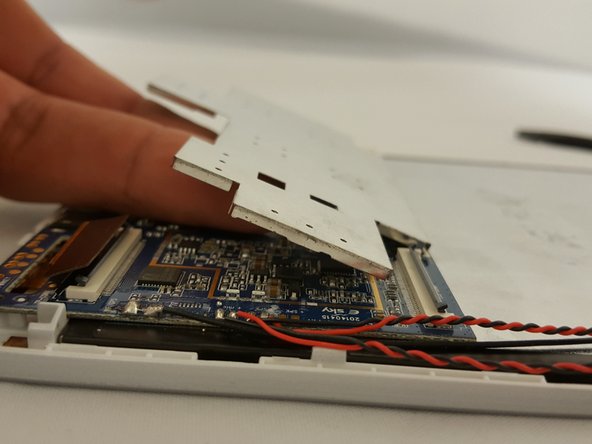

    • This step is optional if you want to remove the metal casing.
    • Insert the pointed side of the spudger in the corner and gently lift.
    • Once one side is lifted, use your fingers and with little force, lift up to remove the case.

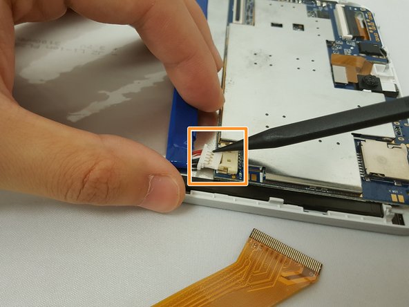

  6. Digital2 D2-861G Motherboard Replacement: crwdns2935265:06crwdnd2935265:01crwdnd2935265:01crwdne2935265:0
    • Use little force or else you risk breaking the motherboard.
    • Watch out for the ZIF connector!
    • There is a white clip holding the motherboard.
    • To remove the motherboard, grab the component on the top left and gently lift while pushing or pulling to the right.
