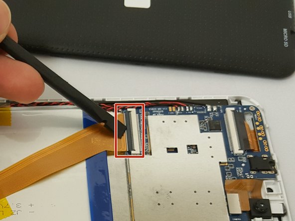

      • Look at the images to locate the black tabs.
      • Carefully remove the tape to avoid damaging the device.

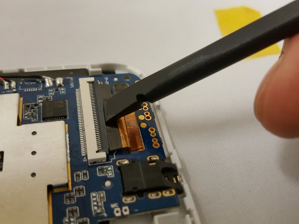

      • Remove ALL the yellow tape securing the gold colored ZIF (Zero insertion force) connector and the battery. Discard or save the tape if you would like.
      • To unclip the connector. Go under the black tab with a spudger or finger nail and simply lift up.

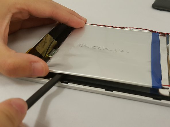

      • Make sure to not bend or puncture the battery when removing it.
      • Locate the bundled cable connector and disconnect it by simply pulling it gently with your hands or using a spudger.
      • Use prying tools to carefully break the adhesive under the battery

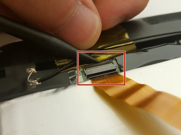

      • Locate the flat-top connector. Go under it with the spudger and simply lift up.

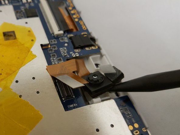

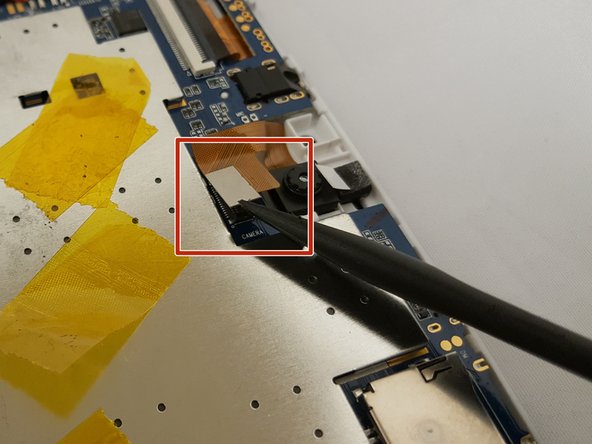

      • To remove the camera, simply use the pointed end of the spudger and insert it in the corner and gently lift.

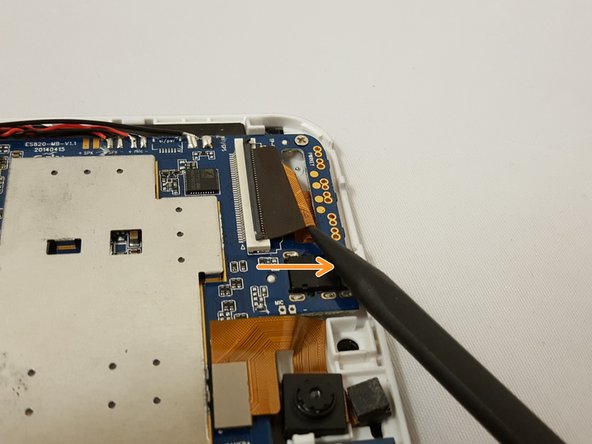

      • Next, unplug the ZIF connector and slide it out with the pointed side of the spudger.
      • To unclip the connector, go under the black tap and simply lift with your finger nail or spudger.

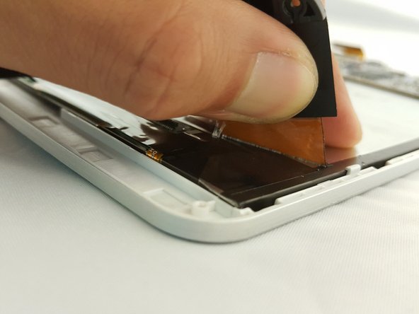

      • Now that every component is removed, use the flat side of the spudger and insert it on the bottom of the screen.
      • Gently move along the edges to lift the screen.
