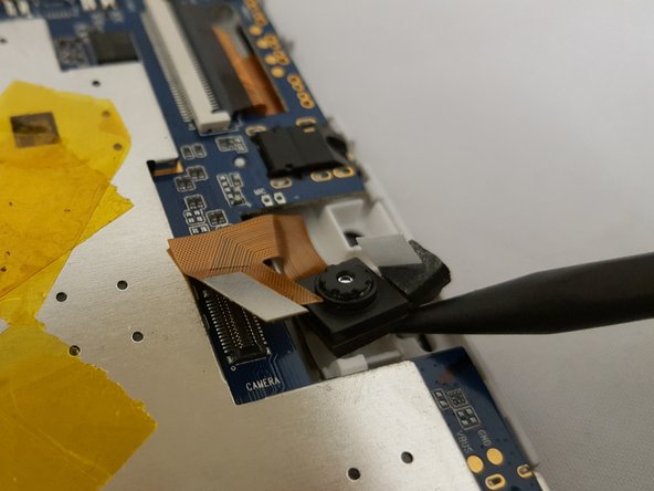

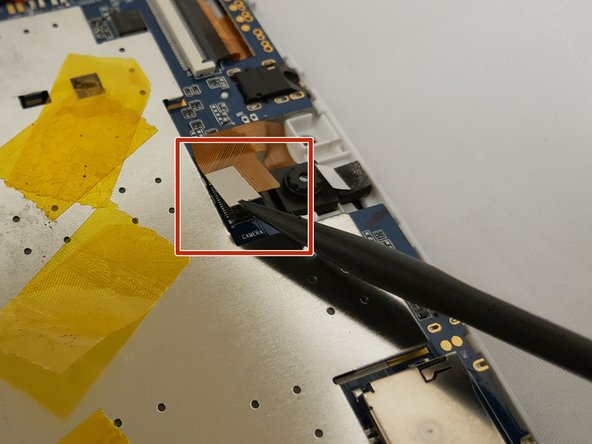

  5. Digital2 D2-861G Camera Replacement: crwdns2935265:05crwdnd2935265:01crwdnd2935265:02crwdne2935265:0 Digital2 D2-861G Camera Replacement: crwdns2935265:05crwdnd2935265:02crwdnd2935265:02crwdne2935265:0
    • Avoid pulling the gold connector as it can be damaged and/or broken.
    • To remove the camera, simply use the pointed end of the spudger and insert it in the corner and gently lift.
