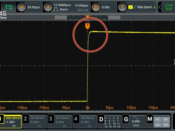

    • Adjust your scope trigger (or use auto on some models) and you should see a square wave as in the picture. The lack of flatness in the response (see circled spot) is what you are compensating for.

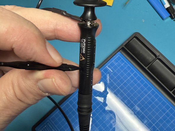

    • Locate the compensation adjustment on your probe. On some probes it is actually on the side of the probe as pictured, on others it can be on the base that plugs into the scope.

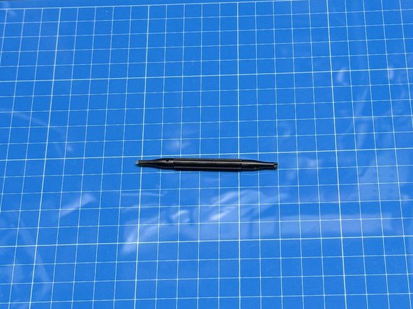

    • Locate the adjustment screwdriver that comes with the probe.
    • Insert the screwdriver into the adjustment hole as shown.

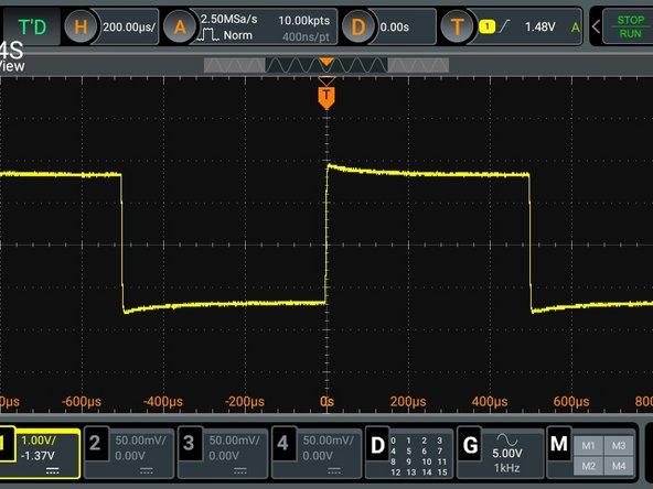

    • Adjust the screw while watching the display until you have the cleanest and flattest wave form.
    • You can adjust the Oscilloscope Horizontal range to give you a better image to work with.
    • If you really open up the Horizontal width, you may see just a slight curve on the rise of the leading edge of the wave, that is fine as there is a slight lag on the rise time.

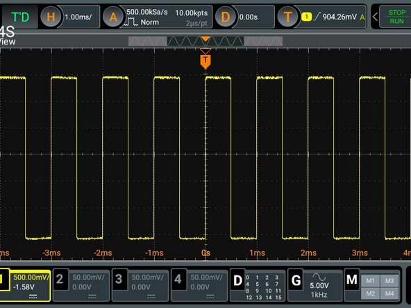

    • When properly compensated, you will have a nice level square wave displayed.
    • If you change the horizontal bandwidth of the scope, you should see the square wave stay flat across the top and bottom.
    • You are done. You are now ready to use your scope to look at signals for troubleshooting and circuit experimentation.
