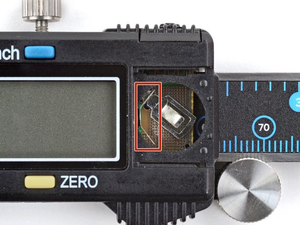

    • Use the pad of your thumb to slide the battery cover away from the display.
    • Remove the battery cover.
  2. Digital Calipers Battery Replacement, Remove the battery: crwdns2935265:02crwdnd2935265:01crwdnd2935265:02crwdne2935265:0 Digital Calipers Battery Replacement, Remove the battery: crwdns2935265:02crwdnd2935265:02crwdnd2935265:02crwdne2935265:0
    • Remove the battery.
  3. Digital Calipers Battery Replacement, Install a new battery: crwdns2935265:03crwdnd2935265:01crwdnd2935265:03crwdne2935265:0 Digital Calipers Battery Replacement, Install a new battery: crwdns2935265:03crwdnd2935265:02crwdnd2935265:03crwdne2935265:0 Digital Calipers Battery Replacement, Install a new battery: crwdns2935265:03crwdnd2935265:03crwdnd2935265:03crwdne2935265:0
    • Insert the new battery at a downward angle into its recess, positive (+) side facing up.
    • A small piece of angled metal secures the battery in its recess.
    • Press down on the battery so it sits flush in the recess.
    • The display should turn on. If it doesn't, even after pressing the on/off button, the battery may be upside down or already dead.
  4. Digital Calipers Battery Replacement, Reinstall the battery cover: crwdns2935265:04crwdnd2935265:01crwdnd2935265:03crwdne2935265:0 Digital Calipers Battery Replacement, Reinstall the battery cover: crwdns2935265:04crwdnd2935265:02crwdnd2935265:03crwdne2935265:0 Digital Calipers Battery Replacement, Reinstall the battery cover: crwdns2935265:04crwdnd2935265:03crwdnd2935265:03crwdne2935265:0
    • Press the outer edge of the battery down with the cover and slide the cover into place.
    • If this feels difficult, the battery may not be seated correctly. Reinsert it and try again.
