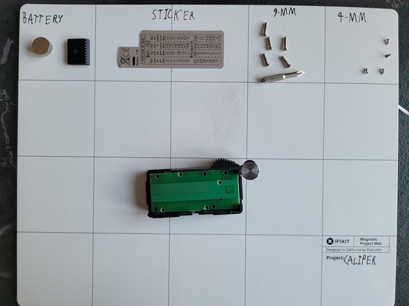

  1. Digital Caliper Teardown, Remove Battery: crwdns2935265:01crwdnd2935265:01crwdnd2935265:02crwdne2935265:0 Digital Caliper Teardown, Remove Battery: crwdns2935265:01crwdnd2935265:02crwdnd2935265:02crwdne2935265:0
    • Slide the battery compartment open.
    • Pull out the battery.
  2. Digital Caliper Teardown, Screw out the housing: crwdns2935265:02crwdnd2935265:01crwdnd2935265:02crwdne2935265:0 Digital Caliper Teardown, Screw out the housing: crwdns2935265:02crwdnd2935265:02crwdnd2935265:02crwdne2935265:0
    • Remove the sticker and place it on a clean sticker-friendly surface.
    • Screw out the 9-mm screws using the J0 Bit.

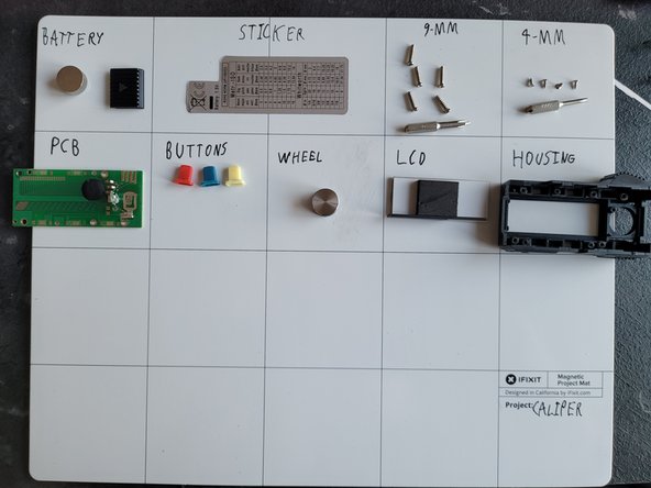

  3. Digital Caliper Teardown, Housing dissasembly: crwdns2935265:03crwdnd2935265:01crwdnd2935265:03crwdne2935265:0 Digital Caliper Teardown, Housing dissasembly: crwdns2935265:03crwdnd2935265:02crwdnd2935265:03crwdne2935265:0 Digital Caliper Teardown, Housing dissasembly: crwdns2935265:03crwdnd2935265:03crwdnd2935265:03crwdne2935265:0
    • Screw out the 4-mm screws holding the PCB in place. Use the J000 bit.
    • Now take out all the parts from the housing.
  4. Digital Caliper Teardown, Body: crwdns2935265:04crwdnd2935265:01crwdnd2935265:02crwdne2935265:0 Digital Caliper Teardown, Body: crwdns2935265:04crwdnd2935265:02crwdnd2935265:02crwdne2935265:0
    • Remove the right/bottom 6mm screws.
    • Then the last 2 and the tightener screws. So you can pull it apart.

Great pictures! I just repaired my caliper using the above (took it apart, cleaned all through and painted some new contact surface on the buttons (not the display rubber-connection). That + a new battery = better than new. Thank you! :)
