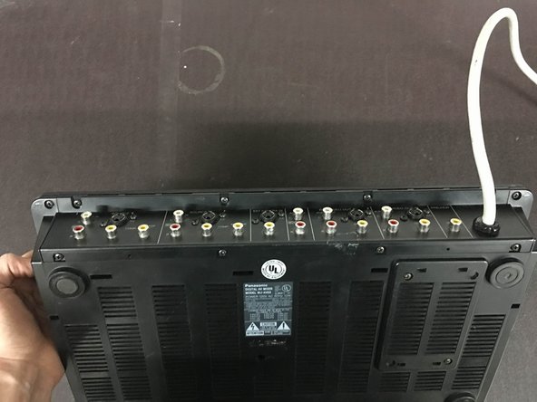

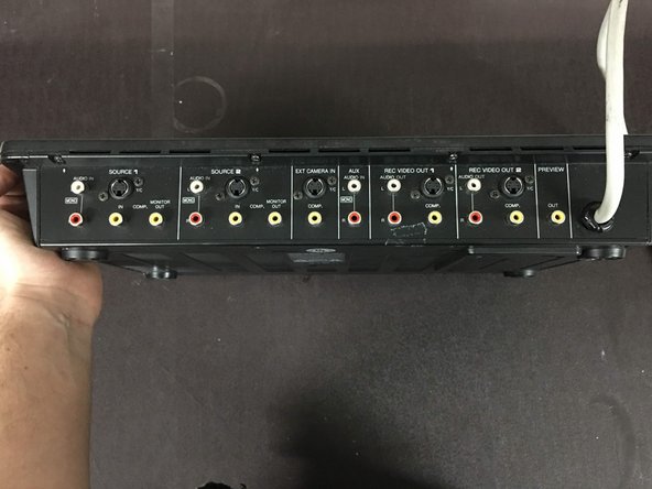

  3. Digital AV Mixer WJ-AVE5 Disassembly, View From Below: crwdns2935265:03crwdnd2935265:01crwdnd2935265:03crwdne2935265:0 Digital AV Mixer WJ-AVE5 Disassembly, View From Below: crwdns2935265:03crwdnd2935265:02crwdnd2935265:03crwdne2935265:0 Digital AV Mixer WJ-AVE5 Disassembly, View From Below: crwdns2935265:03crwdnd2935265:03crwdnd2935265:03crwdne2935265:0
    • This is the bottom of your Digital Mixer. There are Seventeen (17) screws that need to move forward.

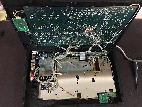

  4. Digital AV Mixer WJ-AVE5 Disassembly, The Pizza Box Open: crwdns2935265:04crwdnd2935265:01crwdnd2935265:02crwdne2935265:0 Digital AV Mixer WJ-AVE5 Disassembly, The Pizza Box Open: crwdns2935265:04crwdnd2935265:02crwdnd2935265:02crwdne2935265:0
    • Now the top-board should pivot up like a pizza-box allowing access to both the solder side of the top-board and the EMI Shielding for both the Primary Power Board and the Primary Control Board.
  5. Digital AV Mixer WJ-AVE5 Disassembly, Solder-Side of Top-Board: crwdns2935265:05crwdnd2935265:01crwdnd2935265:01crwdne2935265:0
    • Shot of the solder-side of the top-board for reference on connector locations, cable routing, and component reference.
  6. Digital AV Mixer WJ-AVE5 Disassembly: crwdns2935265:06crwdnd2935265:01crwdnd2935265:01crwdne2935265:0
    • Shot of the bottom-board for reference on connector locations, cable routing, and component reference.
