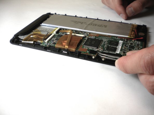

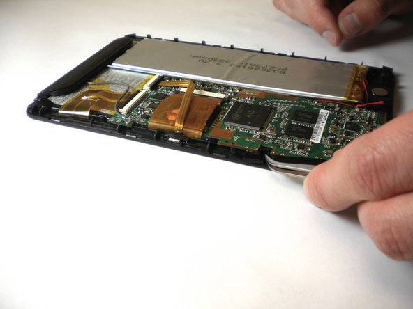

  3. Digitac Jazz Ultratab C725 Volume and Screen Buttons Replacement, Freeing the buttons: crwdns2935265:03crwdnd2935265:01crwdnd2935265:03crwdne2935265:0 Digitac Jazz Ultratab C725 Volume and Screen Buttons Replacement, Freeing the buttons: crwdns2935265:03crwdnd2935265:02crwdnd2935265:03crwdne2935265:0 Digitac Jazz Ultratab C725 Volume and Screen Buttons Replacement, Freeing the buttons: crwdns2935265:03crwdnd2935265:03crwdnd2935265:03crwdne2935265:0
    • Using a pair of tweezers, poke the square plastic piece between each of the buttons that connect them together. Each button has a plastic piece between their gaps.
    • While poking the square piece in, simultaneously push it upward to release it.
    • After releasing the first one, use the pair of tweezers, and do the same with the second one. This should free all buttons from the device.
    • Once the buttons are free, use the set of tweezers to grab the buttons and pull them out.
