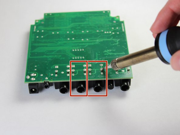

  5. DigiTech RP70 Input/Output ¼” Ports  Replacement, Input/Output ¼” Ports: crwdns2935265:05crwdnd2935265:01crwdnd2935265:02crwdne2935265:0 DigiTech RP70 Input/Output ¼” Ports  Replacement, Input/Output ¼” Ports: crwdns2935265:05crwdnd2935265:02crwdnd2935265:02crwdne2935265:0
    • Desolder the back of the motherboard where the damaged input/output port is located.
