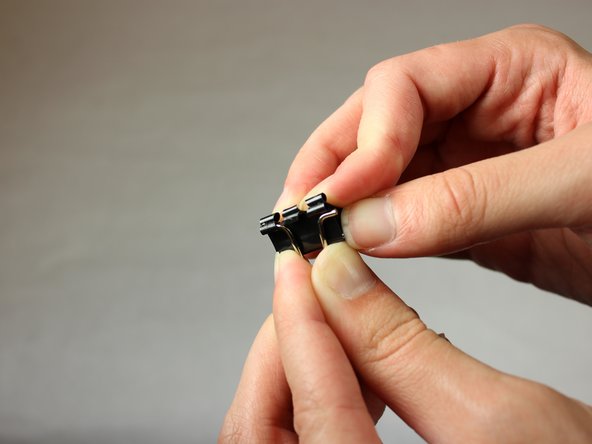

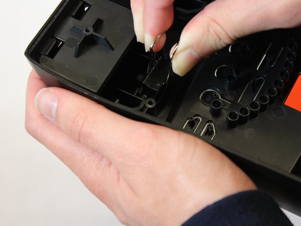

    1. DigiTech RP70  Footswitch Replacement, Footswitches: crwdns2935265:05crwdnd2935265:01crwdnd2935265:03crwdne2935265:0 DigiTech RP70  Footswitch Replacement, Footswitches: crwdns2935265:05crwdnd2935265:02crwdnd2935265:03crwdne2935265:0 DigiTech RP70  Footswitch Replacement, Footswitches: crwdns2935265:05crwdnd2935265:03crwdnd2935265:03crwdne2935265:0
      • Pull firmly on the binder clips that are holding the footswitches in place to remove them.
      • To get the binder clips back in place, you will need to attach handles from another binder clip to hold them open.
    2. DigiTech RP70  Footswitch Replacement: crwdns2935265:06crwdnd2935265:01crwdnd2935265:01crwdne2935265:0
      • Pull the footswitch down and upwards to remove it from the casing.
