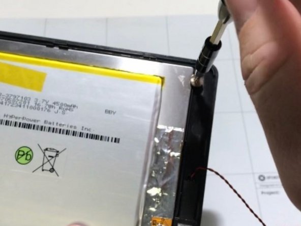

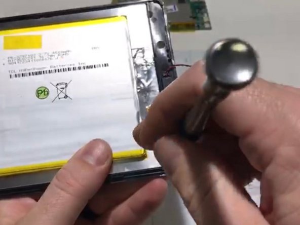

    • Remove the three battery screws using a Phillips #0 screwdriver.

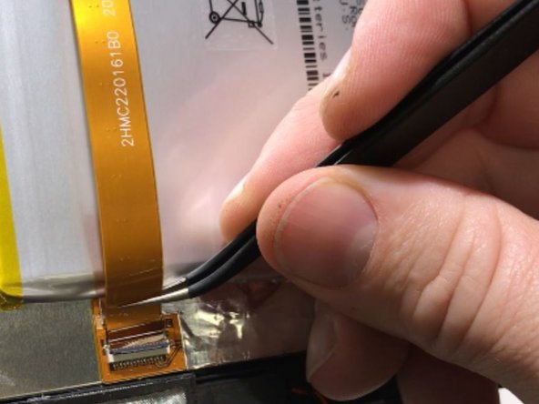

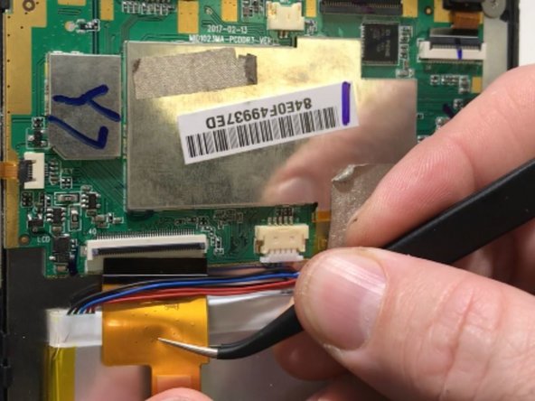

    • Pop up the locking tab of the ZIF connector using tweezers, and carefully pull the cable out from the motherboard.
    • Make sure the ribbon passes under the microphone wiring to avoid damage to the components.
    • Remove the lower section of the ribbon cable repeating the previous bullet.
