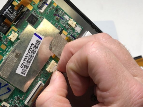

  2. DigiLand DL8006 Motherboard Replacement: crwdns2935265:02crwdnd2935265:01crwdnd2935265:01crwdne2935265:0
    • Peel back the metallic tape connecting the motherboard to the tablet body with your fingers.

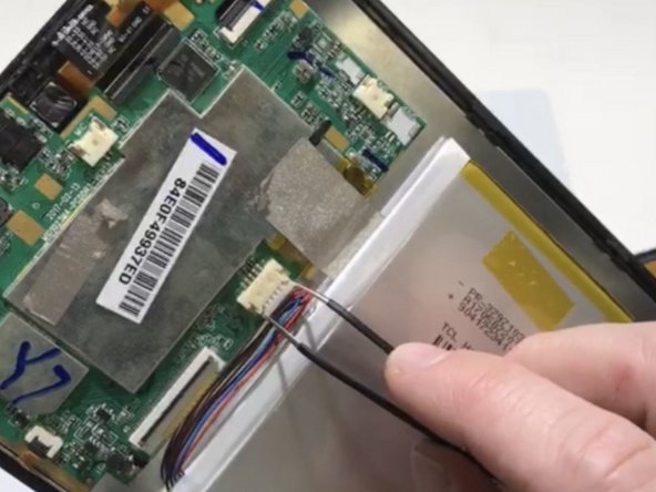

    • Remove the battery plug from the motherboard.
    • Fingers may be used to gently wiggle the connector out if it becomes stuck.
    • If battery wires are under the ribbon, Do Step #4 first.

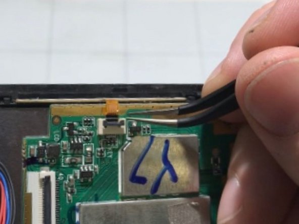

  4. DigiLand DL8006 Motherboard Replacement: crwdns2935265:04crwdnd2935265:01crwdnd2935265:02crwdne2935265:0 DigiLand DL8006 Motherboard Replacement: crwdns2935265:04crwdnd2935265:02crwdnd2935265:02crwdne2935265:0
    • Opening the locking tab of the ZIF connector and carefully remove the upper section of the ribbon cable from the motherboard using tweezers.

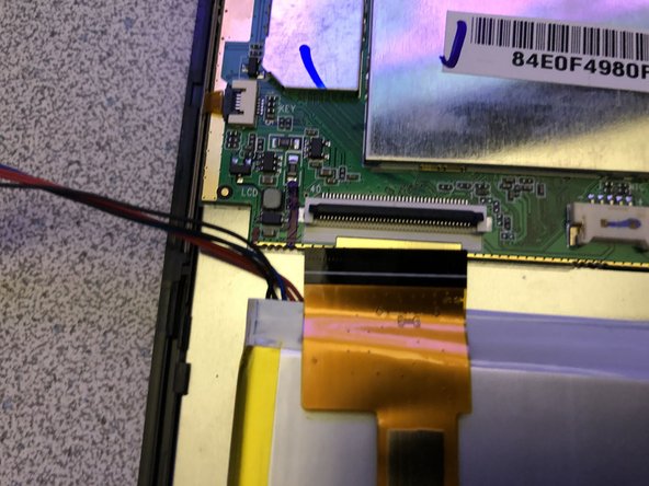

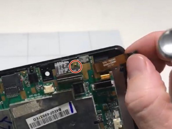

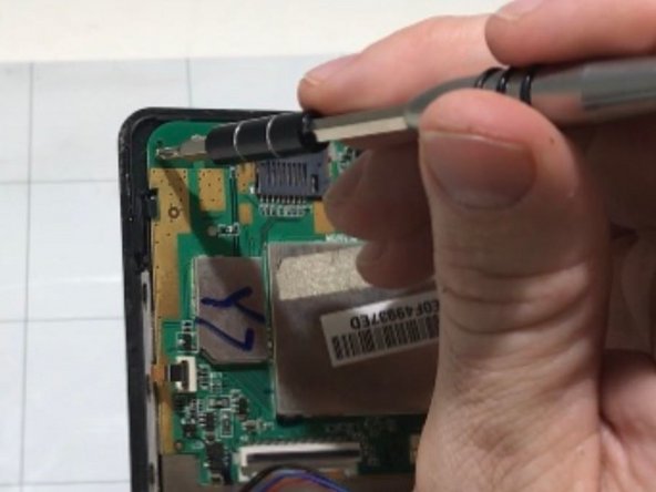

  6. DigiLand DL8006 Motherboard Replacement: crwdns2935265:06crwdnd2935265:01crwdnd2935265:03crwdne2935265:0 DigiLand DL8006 Motherboard Replacement: crwdns2935265:06crwdnd2935265:02crwdnd2935265:03crwdne2935265:0 DigiLand DL8006 Motherboard Replacement: crwdns2935265:06crwdnd2935265:03crwdnd2935265:03crwdne2935265:0
    • Remove the 3 mounting screws from the motherboard with a Phillips #0 screwdriver.
    • One of the screws is located under a ribbon. You will need to gently peel back the cable to access it (see image 3).
