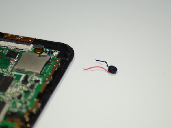

    • Remove back panel by wedging the iFixit opening tool on all four sides of the device.
  2. DigiLand DL718M Microphone Replacement, Microphone: crwdns2935265:02crwdnd2935265:01crwdnd2935265:01crwdne2935265:0
    • Slide the small, circular microphone out of its slot in the bottom left corner of the device using an opening tool.
  3. DigiLand DL718M Microphone Replacement: crwdns2935265:03crwdnd2935265:01crwdnd2935265:02crwdne2935265:0 DigiLand DL718M Microphone Replacement: crwdns2935265:03crwdnd2935265:02crwdnd2935265:02crwdne2935265:0
    • Desolder the two wired connection (red and black) between the microphone and motherboard from the motherboard.
    • Remove the microphone from the tablet.
