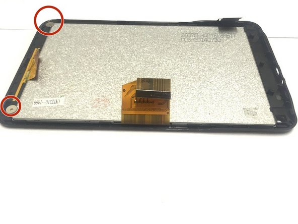

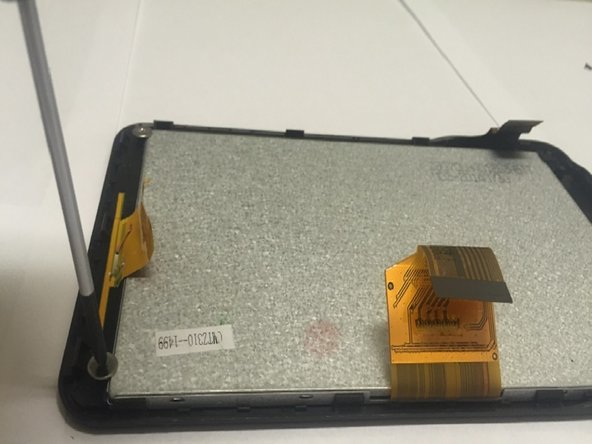

    1. DigiLand DL701Q Screen Replacement, Screen: crwdns2935265:013crwdnd2935265:01crwdnd2935265:03crwdne2935265:0 DigiLand DL701Q Screen Replacement, Screen: crwdns2935265:013crwdnd2935265:02crwdnd2935265:03crwdne2935265:0 DigiLand DL701Q Screen Replacement, Screen: crwdns2935265:013crwdnd2935265:03crwdnd2935265:03crwdne2935265:0
      • Use the tweezers to pry up the antenna strip
      • Locate the two 3mm screws.
      • Remove the two 3mm screws using the PH0 screwdriver.

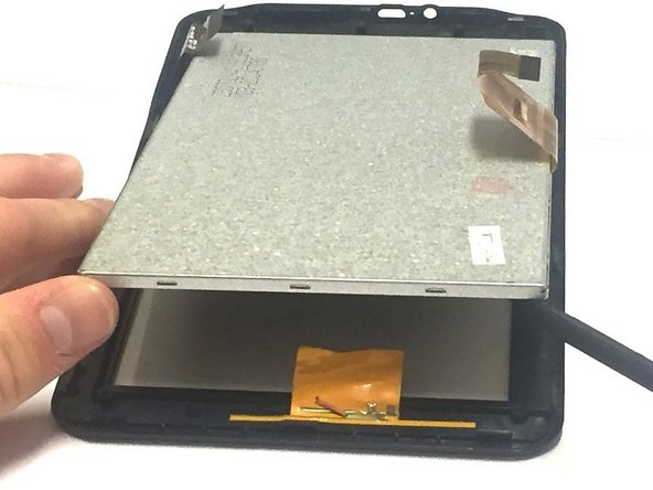

    2. DigiLand DL701Q Screen Replacement: crwdns2935265:014crwdnd2935265:01crwdnd2935265:02crwdne2935265:0 DigiLand DL701Q Screen Replacement: crwdns2935265:014crwdnd2935265:02crwdnd2935265:02crwdne2935265:0
      • Insert the spudger below the corner of the screen and lift the screen up.
      • Gently remove the screen from the device.
