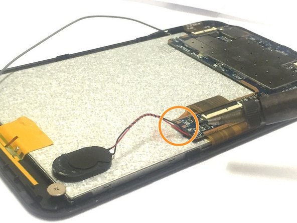

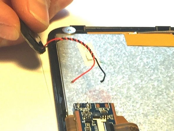

    • Orient the device with the screen facing down as shown in the picture and locate the speaker.
    • Locate where the flash's wires connect to the motherboard.
    • Desolder the speaker's wires from the motherboard and remove the speaker by pulling gently to see if the wires have been desoldered.
    • If you do not know how to desolder look at this soldering and desoldering guide

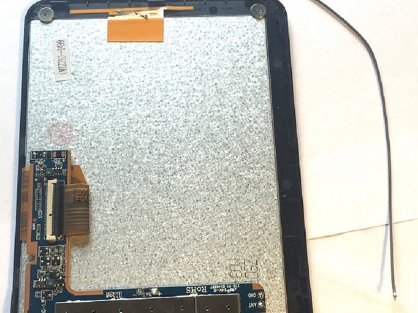

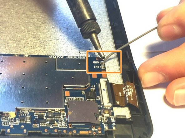

    • With the device flat on the table in the portrait position, grip the device and locate the antenna.
    • There is a connection at the top of the device. Desolder the connection.
    • Now locate the last connection that is attached near the bottom of the device. Desolder this connection.
    • There should no longer be any wires in the device.

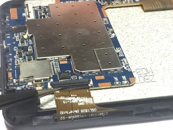

    • Grip the device firmly in hand and locate the black tab.
    • Pull up on the zero insertion force (ZIF) connector with the tweezers to unlock the ribbon.
    • Remove the ribbon by pulling it out using the tweezers.

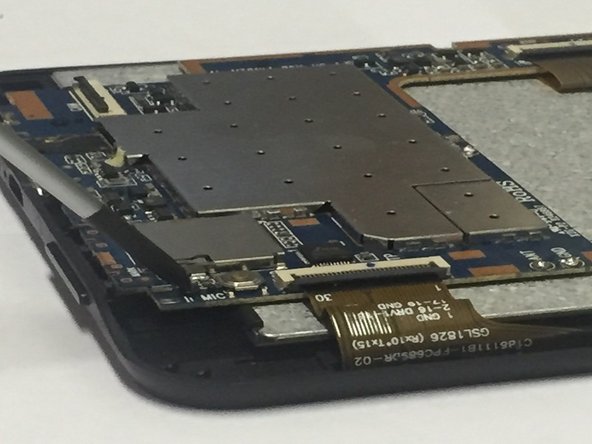

  10. DigiLand DL701Q Motherboard Replacement: crwdns2935265:010crwdnd2935265:01crwdnd2935265:03crwdne2935265:0 DigiLand DL701Q Motherboard Replacement: crwdns2935265:010crwdnd2935265:02crwdnd2935265:03crwdne2935265:0 DigiLand DL701Q Motherboard Replacement: crwdns2935265:010crwdnd2935265:03crwdnd2935265:03crwdne2935265:0

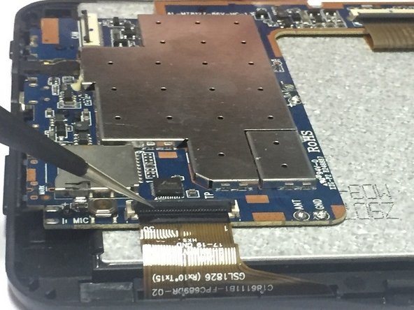

    • Locate the second ribbon that is attached to the motherboard.
    • Pull up on the zero insertion force (ZIF) connector using the tweezers. This will release the ribbon that is locked into place.
    • Pull the ribbon out using the tweezers to remove it from the motherboard.

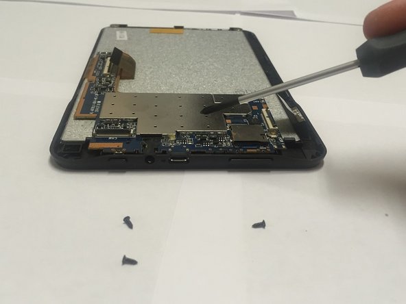

  11. DigiLand DL701Q Motherboard Replacement: crwdns2935265:011crwdnd2935265:01crwdnd2935265:03crwdne2935265:0 DigiLand DL701Q Motherboard Replacement: crwdns2935265:011crwdnd2935265:02crwdnd2935265:03crwdne2935265:0 DigiLand DL701Q Motherboard Replacement: crwdns2935265:011crwdnd2935265:03crwdnd2935265:03crwdne2935265:0
    • Locate the three 4mm screws that attach the motherboard to the device.
    • Use a PH0 screw driver to remove the 4mm screws shown.
  12. DigiLand DL701Q Motherboard Replacement: crwdns2935265:012crwdnd2935265:01crwdnd2935265:01crwdne2935265:0
    • Grip the motherboard and lift up gently and remove the motherboard from the device.
