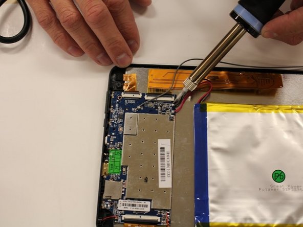

    • Desolder positive and negative, red and black, wires from the mother board that are connected to the battery.
    • The soldering tool is hot, and will burn. For how to use a soldering tool follow the How to Solder Guide

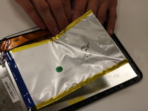

    • Using a metal spudger tool, wedge between battery and metal screen.
    • Follow the edge of the battery to loosen the glue.
  6. DigiLand DL1010Q Screen Replacement: crwdns2935265:06crwdnd2935265:01crwdnd2935265:02crwdne2935265:0 DigiLand DL1010Q Screen Replacement: crwdns2935265:06crwdnd2935265:02crwdnd2935265:02crwdne2935265:0
    • Once the glue is loosened, you should be able to pry off the battery from the screen.
    • Using your hands, pull up on the battery to pull battery off.
    • Pulling on the battery causes you to bend the battery. Bending the battery could cause it to break open. Battery fumes are toxic and unsafe.
    • The battery will be completely disconnected and you can set the battery aside in a safe place.
