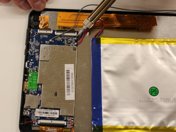

    • Using a Soldering station, desolder all 9 wires connected to the motherboard.
    • Start with the red and black positive and negative wires connected to the battery (2 wires).
    • Then move to the yellow and red twisted wires and black and red twisted wires connected to the speakers (4 wires).
    • Now desolder the single grey wire connected to the antenna (1 wire).
    • Lastly remove the black and red wires connected to the microphone (2 wires).
