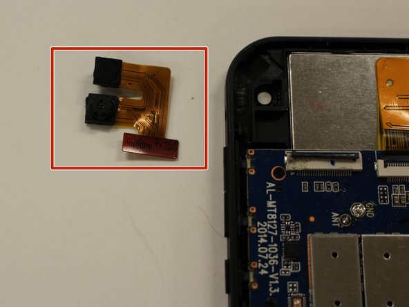

  4. DigiLand DL1010Q Front and Rear Cameras Replacement, Front and Rear Cameras: crwdns2935265:04crwdnd2935265:01crwdnd2935265:01crwdne2935265:0
    • Begin by grabbing the tweezers and locating the ZIF ( zero Insertion Force) connector.
  5. DigiLand DL1010Q Front and Rear Cameras Replacement: crwdns2935265:05crwdnd2935265:01crwdnd2935265:01crwdne2935265:0
    • Insert the tweezers into the black part of the ZIF connector and lift it in an upwards motion. By lifting the connection, you will see it will free the circuit strip.
  6. DigiLand DL1010Q Front and Rear Cameras Replacement: crwdns2935265:06crwdnd2935265:01crwdnd2935265:02crwdne2935265:0 DigiLand DL1010Q Front and Rear Cameras Replacement: crwdns2935265:06crwdnd2935265:02crwdnd2935265:02crwdne2935265:0
    • Take the tweezers and carefully grab the camera closest to the logic board and then pulling in an upwards motion will release both cameras from the device.
    • Set the cameras aside.
