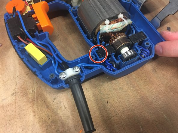

  3. Dexter Corded Jigsaw 750W Charcoal Replacement: crwdns2935265:03crwdnd2935265:01crwdnd2935265:02crwdne2935265:0 Dexter Corded Jigsaw 750W Charcoal Replacement: crwdns2935265:03crwdnd2935265:02crwdnd2935265:02crwdne2935265:0

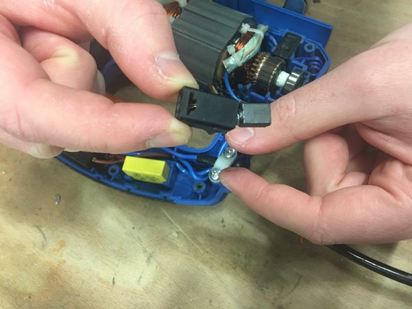

    • Using a screwdriver unscrew and open the unit.
    • Unlock the tray by lifting the lever.
    • Lever the coal out of its housing.
    • Press lightly on the paw with a point to make it come out.
    • Remove the coal by pressing on it.
    • Lift the small tab from the inside by pressing on it, it should stick out slightly.

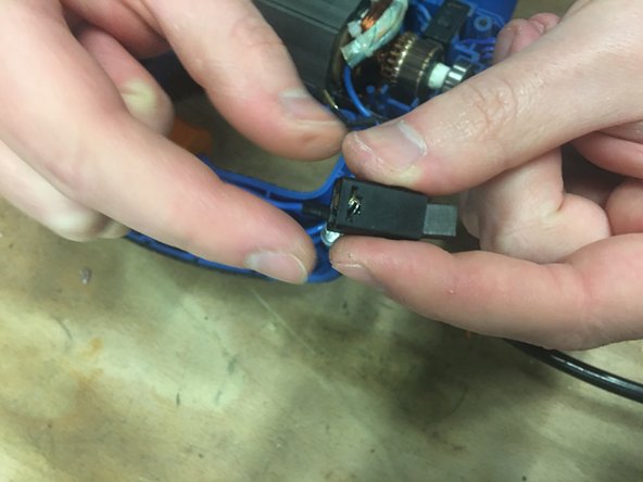

  4. Dexter Corded Jigsaw 750W Charcoal Replacement: crwdns2935265:07crwdnd2935265:01crwdnd2935265:03crwdne2935265:0 Dexter Corded Jigsaw 750W Charcoal Replacement: crwdns2935265:07crwdnd2935265:02crwdnd2935265:03crwdne2935265:0 Dexter Corded Jigsaw 750W Charcoal Replacement: crwdns2935265:07crwdnd2935265:03crwdnd2935265:03crwdne2935265:0
    • Put the new coal in the coal holder.
    • Pull on the charcoal to make it stick out.
    • Clip the tip into the charcoal holder and check that it fits properly.
    • Check the mechanism, so that everything slides perfectly.
