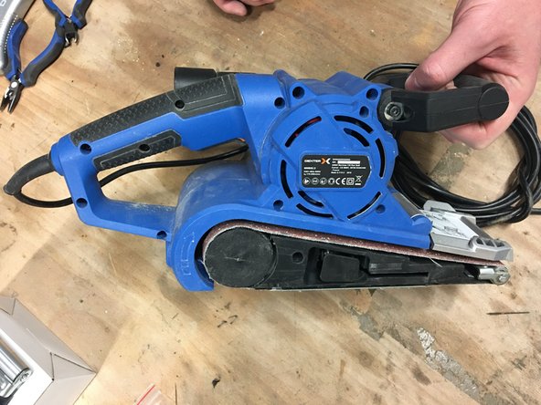

    • Before you begin, remember to disconnect the mains plug.
  2. Dexter Corded Belt Sander - 900BS2.5 Motor Replacement: crwdns2935265:02crwdnd2935265:01crwdnd2935265:03crwdne2935265:0 Dexter Corded Belt Sander - 900BS2.5 Motor Replacement: crwdns2935265:02crwdnd2935265:02crwdnd2935265:03crwdne2935265:0 Dexter Corded Belt Sander - 900BS2.5 Motor Replacement: crwdns2935265:02crwdnd2935265:03crwdnd2935265:03crwdne2935265:0
    • Remove the handle, by unscrewing the screw.

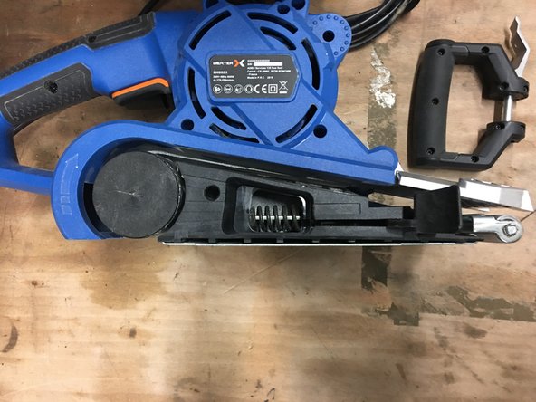

  4. Dexter Corded Belt Sander - 900BS2.5 Motor Replacement: crwdns2935265:04crwdnd2935265:01crwdnd2935265:01crwdne2935265:0
    • Unscrew the 4 screws.

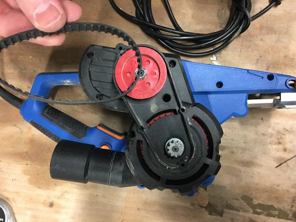

  5. Dexter Corded Belt Sander - 900BS2.5 Motor Replacement: crwdns2935265:05crwdnd2935265:01crwdnd2935265:02crwdne2935265:0 Dexter Corded Belt Sander - 900BS2.5 Motor Replacement: crwdns2935265:05crwdnd2935265:02crwdnd2935265:02crwdne2935265:0

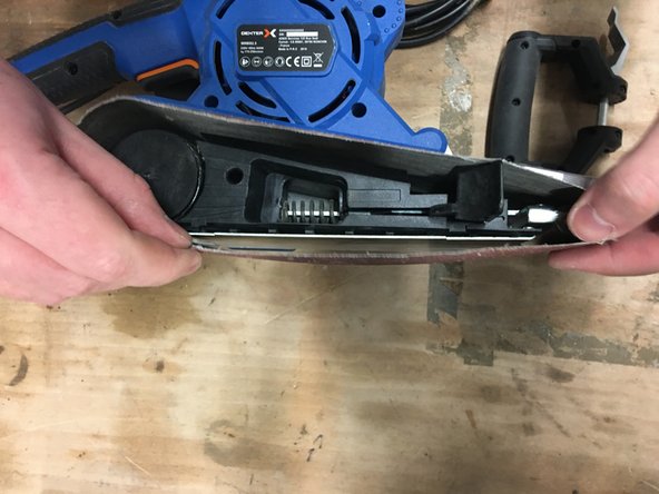

    • Remove the belt, then unscrew the screws of the shell to gain access to the motor.
    • Collect the belt to place it in the new room.

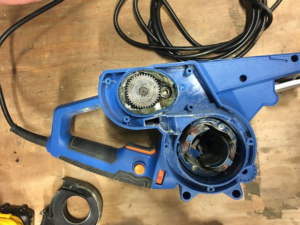

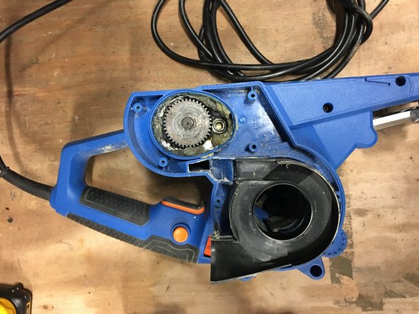

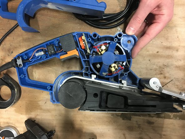

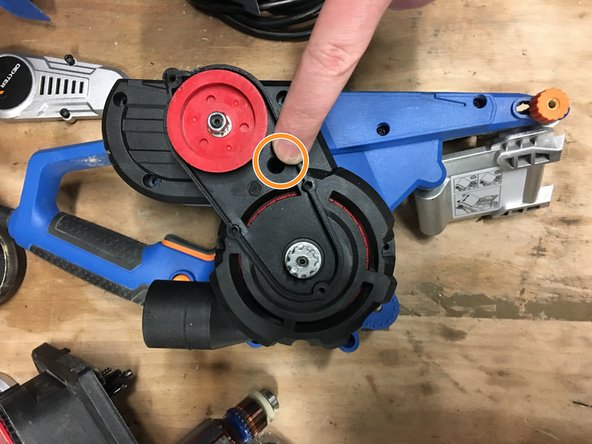

    • Remove the screws from the hull in order to have access to the interior and allow the carbon brushes to be blocked.
    • Relax the small metal strip to be able to separate the carbons.
    • Replace the new part in its housing.
