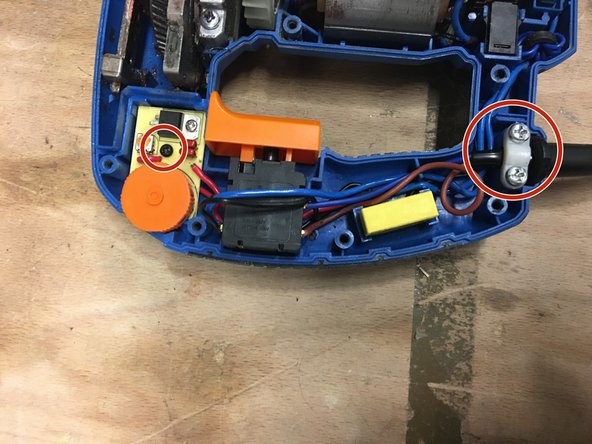

  4. Dexter 750W Wired Jigsaw Power Cable Replacement: crwdns2935265:04crwdnd2935265:01crwdnd2935265:01crwdne2935265:0
    • Remove the two screws to unlock the cable.

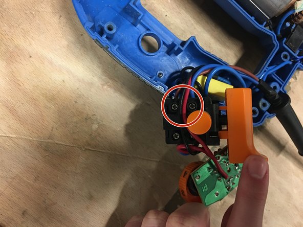

    • Turn the switch over.
    • Unscrew the 2 screws to remove the blue and brown cables.
  7. Dexter 750W Wired Jigsaw Power Cable Replacement: crwdns2935265:08crwdnd2935265:01crwdnd2935265:01crwdne2935265:0
    • Reconnect the new cable.
    • The brown thread must be at the top and the blue thread must be at the bottom.
