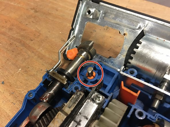

    • Remove the steel bar and remove the orange button.
  4. Dexter 750W Pendular Button Replacement Corded Jigsaw: crwdns2935265:06crwdnd2935265:01crwdnd2935265:01crwdne2935265:0
    • Be careful when removing the orange button not to lose the ball and the spring.
  5. Dexter 750W Pendular Button Replacement Corded Jigsaw: crwdns2935265:07crwdnd2935265:01crwdnd2935265:02crwdne2935265:0 Dexter 750W Pendular Button Replacement Corded Jigsaw: crwdns2935265:07crwdnd2935265:02crwdnd2935265:02crwdne2935265:0
    • Replace the ball and spring on the new button.
    • Put it back in the machine.
