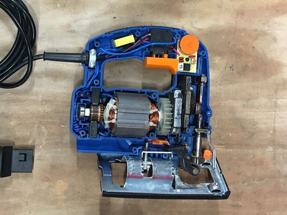

    • Before you begin, remember to disconnect the mains plug.
  2. Dexter 750W Corded Jigsaw Motor Replacement: crwdns2935265:02crwdnd2935265:01crwdnd2935265:01crwdne2935265:0
    • Remove the vacuum adapter from the back of the device.
  3. Dexter 750W Corded Jigsaw Motor Replacement: crwdns2935265:03crwdnd2935265:01crwdnd2935265:02crwdne2935265:0 Dexter 750W Corded Jigsaw Motor Replacement: crwdns2935265:03crwdnd2935265:02crwdnd2935265:02crwdne2935265:0
    • Using a screwdriver or screwdriver, unscrew and open the device.
    • Unlock the tray by lifting the lever.
    • Use needle nose pliers and remove the clip located next to the blade holder.
    • Remove the blade holder, keeping the slider at the end of the holder.
  4. Dexter 750W Corded Jigsaw Motor Replacement: crwdns2935265:06crwdnd2935265:01crwdnd2935265:01crwdne2935265:0
    • Unscrew the two screws and set them aside.
    • Remove the two carbons located next to the stator.
    • Lift the stator, then lever out the motor.
  5. Dexter 750W Corded Jigsaw Motor Replacement: crwdns2935265:09crwdnd2935265:01crwdnd2935265:01crwdne2935265:0
    • Put the new motor back in its place.
  6. Dexter 750W Corded Jigsaw Motor Replacement: crwdns2935265:010crwdnd2935265:01crwdnd2935265:02crwdne2935265:0 Dexter 750W Corded Jigsaw Motor Replacement: crwdns2935265:010crwdnd2935265:02crwdnd2935265:02crwdne2935265:0
    • Collect the end cap on the old engine.
    • Put it back on the new motor.
    • Put some grease on the tip.
  7. Dexter 750W Corded Jigsaw Motor Replacement: crwdns2935265:011crwdnd2935265:01crwdnd2935265:01crwdne2935265:0
    • Replace the two screws to stabilize the motor.
    • Return the blade holder to its location
    • Make sure you put each piece in its place.
    • Replace the staple in the same location. The curved side of the staple should go to the rounded side of the bracket.
    • Lubricate the whole
  8. Dexter 750W Corded Jigsaw Motor Replacement: crwdns2935265:014crwdnd2935265:01crwdnd2935265:02crwdne2935265:0 Dexter 750W Corded Jigsaw Motor Replacement: crwdns2935265:014crwdnd2935265:02crwdnd2935265:02crwdne2935265:0
    • Put the coals back in their places.
  9. Dexter 750W Corded Jigsaw Motor Replacement: crwdns2935265:015crwdnd2935265:01crwdnd2935265:01crwdne2935265:0
    • Before closing, lubricate each gear.
  10. Dexter 750W Corded Jigsaw Motor Replacement: crwdns2935265:016crwdnd2935265:01crwdnd2935265:01crwdne2935265:0
    • Close and screw the device.
follow guide through or in reverse to reassemble
