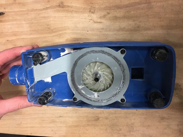

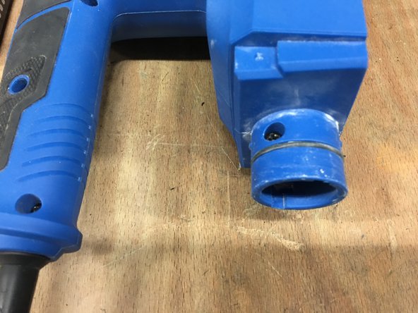

    • Remove the dust case and the seal on the back of the device.
  3. Dexter 330W Wired Vibrating Sander - 330SHS2.5 Carbon Replacement: crwdns2935265:03crwdnd2935265:01crwdnd2935265:03crwdne2935265:0 Dexter 330W Wired Vibrating Sander - 330SHS2.5 Carbon Replacement: crwdns2935265:03crwdnd2935265:02crwdnd2935265:03crwdne2935265:0 Dexter 330W Wired Vibrating Sander - 330SHS2.5 Carbon Replacement: crwdns2935265:03crwdnd2935265:03crwdnd2935265:03crwdne2935265:0

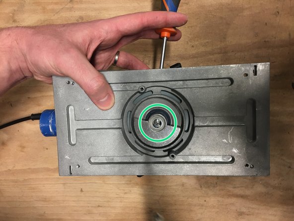

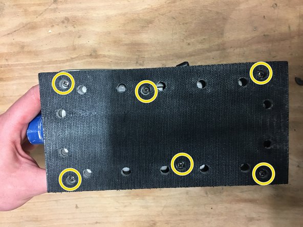

    • Unscrew the six screws from the pad.
    • Lock the motor with a screwdriver to be able to unscrew the centre screw, you will not be able to get there without blocking the gear.

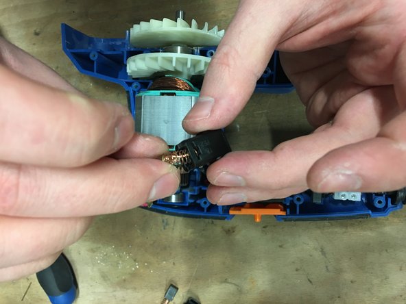

  4. Dexter 330W Wired Vibrating Sander - 330SHS2.5 Carbon Replacement: crwdns2935265:04crwdnd2935265:01crwdnd2935265:02crwdne2935265:0 Dexter 330W Wired Vibrating Sander - 330SHS2.5 Carbon Replacement: crwdns2935265:04crwdnd2935265:02crwdnd2935265:02crwdne2935265:0

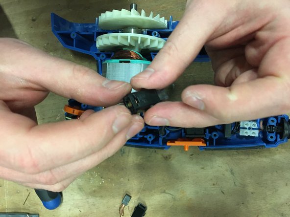

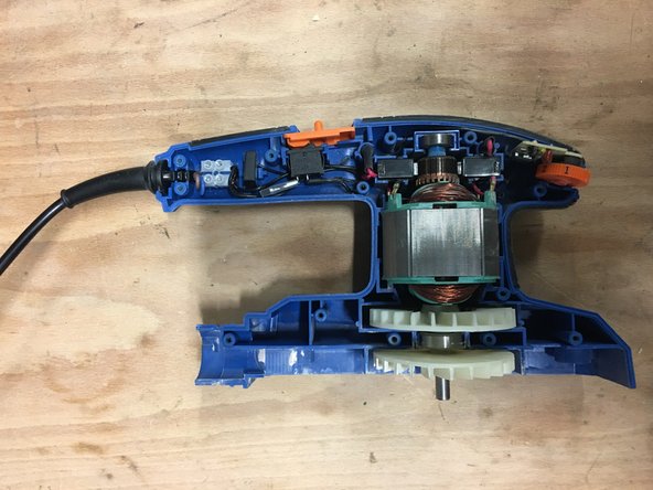

    • Using a screwdriver or screwdriver, unscrew and open the device.
    • Lift the two coals with a screwdriver to get them out of their homes.
    • Press the tab to disconnect the carbon from the engine
  5. Dexter 330W Wired Vibrating Sander - 330SHS2.5 Carbon Replacement: crwdns2935265:07crwdnd2935265:01crwdnd2935265:03crwdne2935265:0 Dexter 330W Wired Vibrating Sander - 330SHS2.5 Carbon Replacement: crwdns2935265:07crwdnd2935265:02crwdnd2935265:03crwdne2935265:0 Dexter 330W Wired Vibrating Sander - 330SHS2.5 Carbon Replacement: crwdns2935265:07crwdnd2935265:03crwdnd2935265:03crwdne2935265:0
    • Remove the coals from the coal door.
    • Then put the new ones inside.
  6. Dexter 330W Wired Vibrating Sander - 330SHS2.5 Carbon Replacement: crwdns2935265:08crwdnd2935265:01crwdnd2935265:01crwdne2935265:0
    • Using a screwdriver, lift the connecter tab before reconnecting it.
    • Reconnect the carbon and check that they hold well.

    • Replace the shell, then screw it back on.
    • Remember to put the joint back in its place.

    • Reposition the part, then lock the engine with a screwdriver to screw.
    • Put the tray back on and screw the screws.

    • Finally, reposition the vacuum bag.
