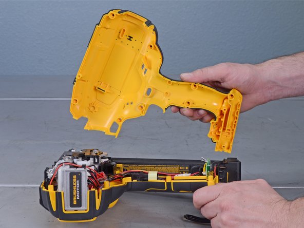

  3. Dewalt Nailers PTO Assembly Replacement, Remove the right housing: crwdns2935265:03crwdnd2935265:01crwdnd2935265:02crwdne2935265:0 Dewalt Nailers PTO Assembly Replacement, Remove the right housing: crwdns2935265:03crwdnd2935265:02crwdnd2935265:02crwdne2935265:0
    • Lay the device on its left side (with the belt hook).
    • Lift and remove the right housing from the device.

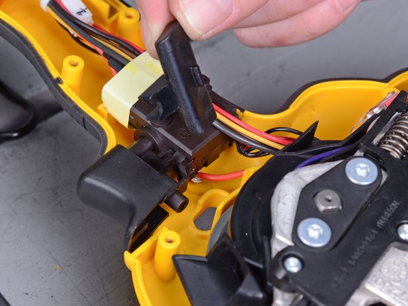

  4. Dewalt Nailers PTO Assembly Replacement, Loosen the internal parts: crwdns2935265:04crwdnd2935265:01crwdnd2935265:02crwdne2935265:0 Dewalt Nailers PTO Assembly Replacement, Loosen the internal parts: crwdns2935265:04crwdnd2935265:02crwdnd2935265:02crwdne2935265:0
    • Remove the lock button from its recess.
    • During reassembly, make sure that the button is properly seated and engages the trigger.

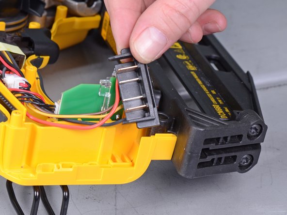

  5. Dewalt Nailers PTO Assembly Replacement: crwdns2935265:05crwdnd2935265:01crwdnd2935265:02crwdne2935265:0 Dewalt Nailers PTO Assembly Replacement: crwdns2935265:05crwdnd2935265:02crwdnd2935265:02crwdne2935265:0
    • Slide the battery connector out of its recess.

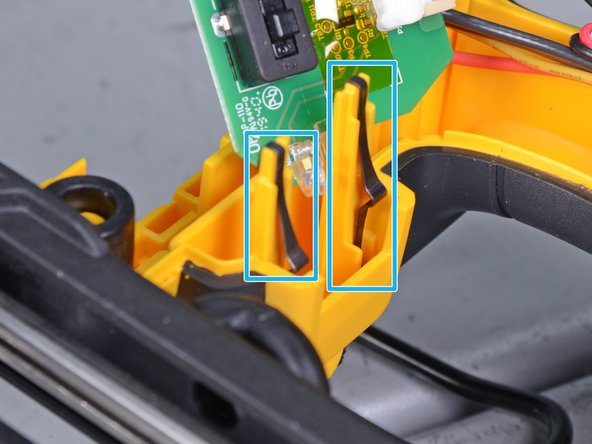

  6. Dewalt Nailers PTO Assembly Replacement: crwdns2935265:06crwdnd2935265:01crwdnd2935265:03crwdne2935265:0 Dewalt Nailers PTO Assembly Replacement: crwdns2935265:06crwdnd2935265:02crwdnd2935265:03crwdne2935265:0 Dewalt Nailers PTO Assembly Replacement: crwdns2935265:06crwdnd2935265:03crwdnd2935265:03crwdne2935265:0

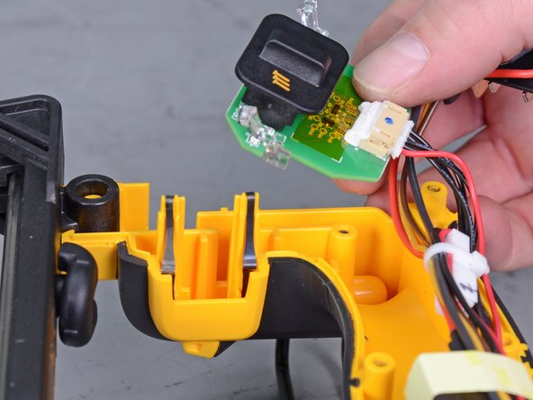

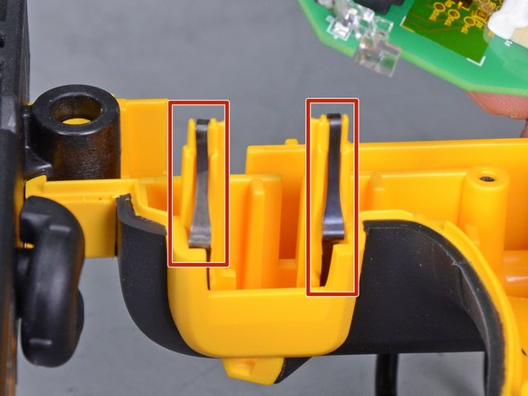

    • Remove the switch board from its housing recess.
    • Remove the two spring clips from the housing.
  7. Dewalt Nailers PTO Assembly Replacement, Reassembly tip: crwdns2935265:07crwdnd2935265:01crwdnd2935265:03crwdne2935265:0 Dewalt Nailers PTO Assembly Replacement, Reassembly tip: crwdns2935265:07crwdnd2935265:02crwdnd2935265:03crwdne2935265:0 Dewalt Nailers PTO Assembly Replacement, Reassembly tip: crwdns2935265:07crwdnd2935265:03crwdnd2935265:03crwdne2935265:0
    • During reassembly, use these photos to help you align all the loose parts back into the housing.
    • Be sure to route the wires through the yellow groove.
    • Be sure to reattach the spring clips.

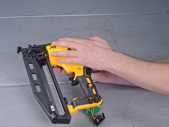

  8. Dewalt Nailers PTO Assembly Replacement, Remove the left housing: crwdns2935265:08crwdnd2935265:01crwdnd2935265:03crwdne2935265:0 Dewalt Nailers PTO Assembly Replacement, Remove the left housing: crwdns2935265:08crwdnd2935265:02crwdnd2935265:03crwdne2935265:0 Dewalt Nailers PTO Assembly Replacement, Remove the left housing: crwdns2935265:08crwdnd2935265:03crwdnd2935265:03crwdne2935265:0
    • Carefully flip the device over.
    • Remove the left housing from the device.

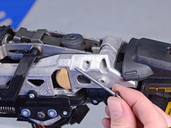

  10. Dewalt Nailers PTO Assembly Replacement, Dewalt Nailers DCN660D1 2018 Solenoid Removal: crwdns2935265:010crwdnd2935265:01crwdnd2935265:02crwdne2935265:0 Dewalt Nailers PTO Assembly Replacement, Dewalt Nailers DCN660D1 2018 Solenoid Removal: crwdns2935265:010crwdnd2935265:02crwdnd2935265:02crwdne2935265:0

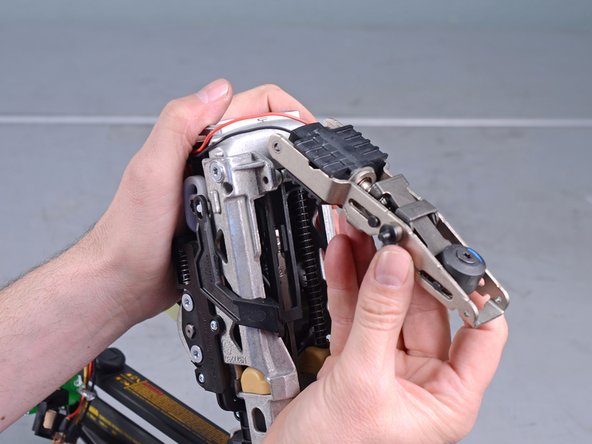

    • Slide the dowel pin securing the PTO assembly out of the device.

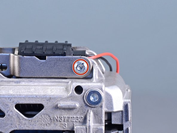

  11. Dewalt Nailers PTO Assembly Replacement, Loosen the solenoid assembly: crwdns2935265:011crwdnd2935265:01crwdnd2935265:02crwdne2935265:0 Dewalt Nailers PTO Assembly Replacement, Loosen the solenoid assembly: crwdns2935265:011crwdnd2935265:02crwdnd2935265:02crwdne2935265:0
    • Use a T10 driver to remove the two screws securing the solenoid.

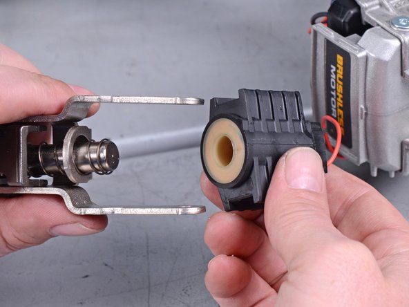

  12. Dewalt Nailers PTO Assembly Replacement: crwdns2935265:012crwdnd2935265:01crwdnd2935265:02crwdne2935265:0 Dewalt Nailers PTO Assembly Replacement: crwdns2935265:012crwdnd2935265:02crwdnd2935265:02crwdne2935265:0

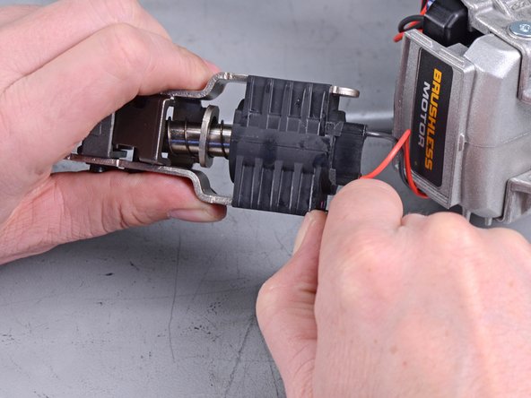

    • Lift the solenoid away from the device.
    • The solenoid is still connected to the device by two wires. Be careful not to strain the wires.

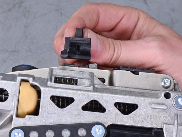

  13. Dewalt Nailers PTO Assembly Replacement: crwdns2935265:013crwdnd2935265:01crwdnd2935265:03crwdne2935265:0 Dewalt Nailers PTO Assembly Replacement: crwdns2935265:013crwdnd2935265:02crwdnd2935265:03crwdne2935265:0 Dewalt Nailers PTO Assembly Replacement: crwdns2935265:013crwdnd2935265:03crwdnd2935265:03crwdne2935265:0
    • Slide the solenoid off the PTO assembly's rails.

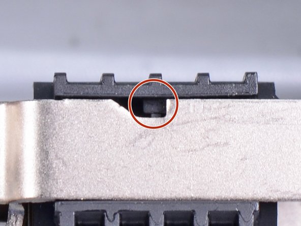

  14. Dewalt Nailers PTO Assembly Replacement, Reassembly tip: crwdns2935265:014crwdnd2935265:01crwdnd2935265:02crwdne2935265:0 Dewalt Nailers PTO Assembly Replacement, Reassembly tip: crwdns2935265:014crwdnd2935265:02crwdnd2935265:02crwdne2935265:0
    • Reassembly tip: When you slide the solenoid back onto the PTO assembly, make sure to align the plastic pin to the notch.

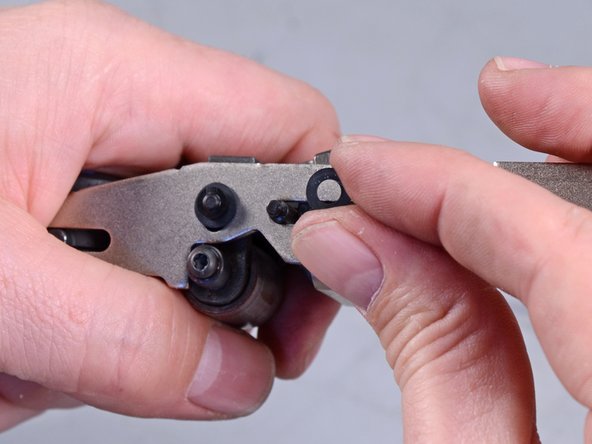

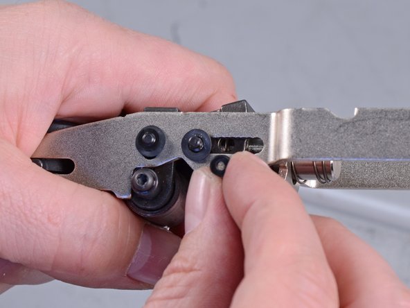

  15. Dewalt Nailers PTO Assembly Replacement, Transfer the minor components: crwdns2935265:015crwdnd2935265:01crwdnd2935265:03crwdne2935265:0 Dewalt Nailers PTO Assembly Replacement, Transfer the minor components: crwdns2935265:015crwdnd2935265:02crwdnd2935265:03crwdne2935265:0 Dewalt Nailers PTO Assembly Replacement, Transfer the minor components: crwdns2935265:015crwdnd2935265:03crwdnd2935265:03crwdne2935265:0
    • Use a flathead screwdriver to pry off the rubber stopper securing the plunger pin.
    • Retain the rubber stopper and washer for your replacement assembly.

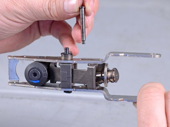

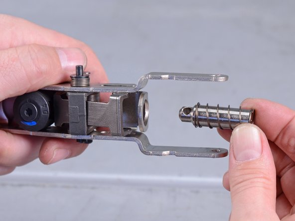

  16. Dewalt Nailers PTO Assembly Replacement: crwdns2935265:016crwdnd2935265:01crwdnd2935265:02crwdne2935265:0 Dewalt Nailers PTO Assembly Replacement: crwdns2935265:016crwdnd2935265:02crwdnd2935265:02crwdne2935265:0
    • Remove the plunger pin from the PTO assembly.
  17. Dewalt Nailers PTO Assembly Replacement: crwdns2935265:017crwdnd2935265:01crwdnd2935265:02crwdne2935265:0 Dewalt Nailers PTO Assembly Replacement: crwdns2935265:017crwdnd2935265:02crwdnd2935265:02crwdne2935265:0
    • Remove the plunger and spring from the PTO assembly.
    • Install the plunger, spring, and pin onto your replacement assembly.
