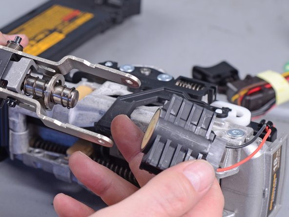

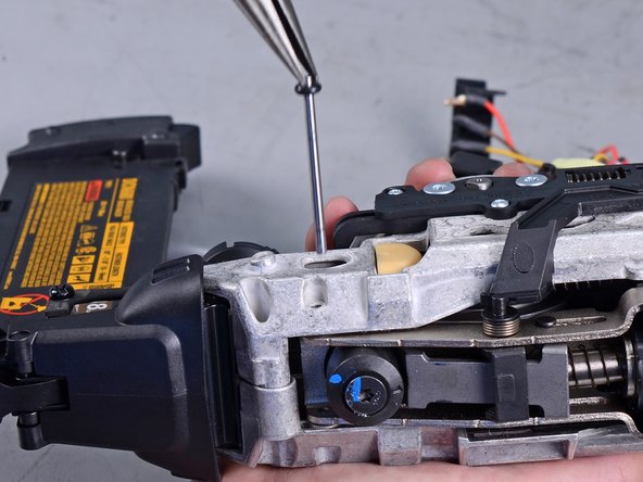

    • Slide the dowel pin securing the PTO assembly out of the device.
  13. Dewalt Nailers DCN680D1 2018 PTO Assembly Replacement, Loosen the solenoid assembly: crwdns2935265:013crwdnd2935265:01crwdnd2935265:02crwdne2935265:0 Dewalt Nailers DCN680D1 2018 PTO Assembly Replacement, Loosen the solenoid assembly: crwdns2935265:013crwdnd2935265:02crwdnd2935265:02crwdne2935265:0
    • Use a T10 driver to remove the two screws securing the solenoid.

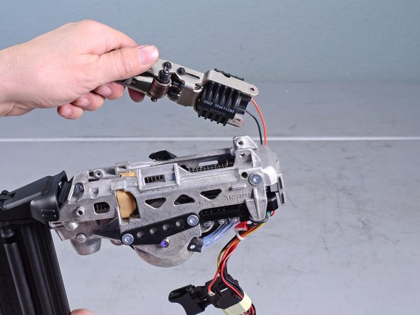

  14. Dewalt Nailers DCN680D1 2018 PTO Assembly Replacement: crwdns2935265:014crwdnd2935265:01crwdnd2935265:03crwdne2935265:0 Dewalt Nailers DCN680D1 2018 PTO Assembly Replacement: crwdns2935265:014crwdnd2935265:02crwdnd2935265:03crwdne2935265:0 Dewalt Nailers DCN680D1 2018 PTO Assembly Replacement: crwdns2935265:014crwdnd2935265:03crwdnd2935265:03crwdne2935265:0
    • Lift the solenoid away from the device.
    • The solenoid is still connected to the device by two wires. Be careful not to strain the wires.

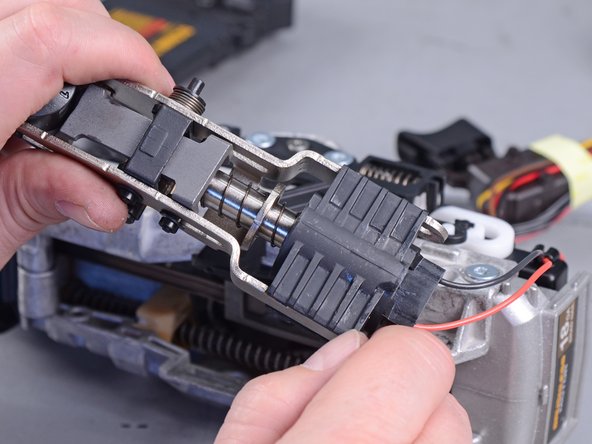

  15. Dewalt Nailers DCN680D1 2018 PTO Assembly Replacement: crwdns2935265:015crwdnd2935265:01crwdnd2935265:03crwdne2935265:0 Dewalt Nailers DCN680D1 2018 PTO Assembly Replacement: crwdns2935265:015crwdnd2935265:02crwdnd2935265:03crwdne2935265:0 Dewalt Nailers DCN680D1 2018 PTO Assembly Replacement: crwdns2935265:015crwdnd2935265:03crwdnd2935265:03crwdne2935265:0
    • Slide the solenoid off the PTO assembly's rails.
  16. Dewalt Nailers DCN680D1 2018 PTO Assembly Replacement, Reassembly tip: crwdns2935265:016crwdnd2935265:01crwdnd2935265:02crwdne2935265:0 Dewalt Nailers DCN680D1 2018 PTO Assembly Replacement, Reassembly tip: crwdns2935265:016crwdnd2935265:02crwdnd2935265:02crwdne2935265:0
    • Reassembly tip: When you slide the solenoid back onto the PTO assembly, make sure to align the plastic pin to the notch.

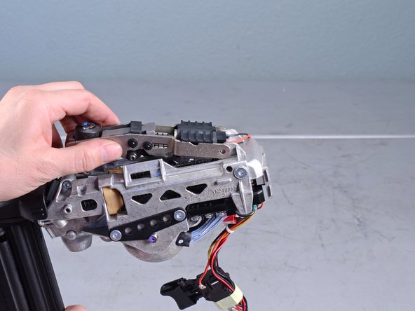

    • Remove the plunger pin from the PTO assembly.
  19. Dewalt Nailers DCN680D1 2018 PTO Assembly Replacement: crwdns2935265:019crwdnd2935265:01crwdnd2935265:02crwdne2935265:0 Dewalt Nailers DCN680D1 2018 PTO Assembly Replacement: crwdns2935265:019crwdnd2935265:02crwdnd2935265:02crwdne2935265:0
    • Remove the plunger and spring from the PTO assembly.
    • Install the plunger, spring, and pin onto your replacement assembly.
  20. Dewalt Nailers DCN680D1 2018 PTO Assembly Replacement: crwdns2935265:020crwdnd2935265:01crwdnd2935265:01crwdne2935265:0
    • Only the PTO assembly remains.
