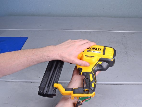

  2. Dewalt Nailers DCN680D1 2018 Driver Blade Replacement, Loosen the outer housing: crwdns2935265:02crwdnd2935265:01crwdnd2935265:01crwdne2935265:0
    • Remove the following screws securing the outer housing:
    • Twelve T10 screws
    • One 2.5 mm hex screw
    • Some of these screws are deeply recessed. You can use a flathead screwdriver to loosen these screws.
  3. Dewalt Nailers DCN680D1 2018 Driver Blade Replacement, Remove the right housing: crwdns2935265:03crwdnd2935265:01crwdnd2935265:02crwdne2935265:0 Dewalt Nailers DCN680D1 2018 Driver Blade Replacement, Remove the right housing: crwdns2935265:03crwdnd2935265:02crwdnd2935265:02crwdne2935265:0
    • Lift and remove the right housing from the device.

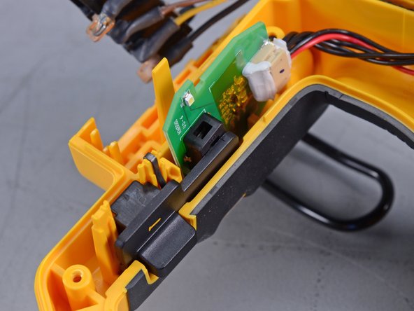

  6. Dewalt Nailers DCN680D1 2018 Driver Blade Replacement: crwdns2935265:06crwdnd2935265:01crwdnd2935265:03crwdne2935265:0 Dewalt Nailers DCN680D1 2018 Driver Blade Replacement: crwdns2935265:06crwdnd2935265:02crwdnd2935265:03crwdne2935265:0 Dewalt Nailers DCN680D1 2018 Driver Blade Replacement: crwdns2935265:06crwdnd2935265:03crwdnd2935265:03crwdne2935265:0

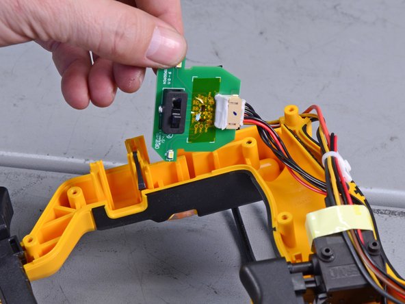

    • Remove the switch board, switch, and spring from its housing recess.
    • During reassembly, use the third photo as a reference to help you set the components back in the housing.

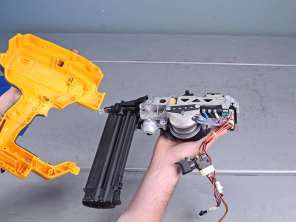

  7. Dewalt Nailers DCN680D1 2018 Driver Blade Replacement, Remove the left housing: crwdns2935265:07crwdnd2935265:01crwdnd2935265:03crwdne2935265:0 Dewalt Nailers DCN680D1 2018 Driver Blade Replacement, Remove the left housing: crwdns2935265:07crwdnd2935265:02crwdnd2935265:03crwdne2935265:0 Dewalt Nailers DCN680D1 2018 Driver Blade Replacement, Remove the left housing: crwdns2935265:07crwdnd2935265:03crwdnd2935265:03crwdne2935265:0
    • Carefully flip the device over.
    • Remove the left housing from the device.

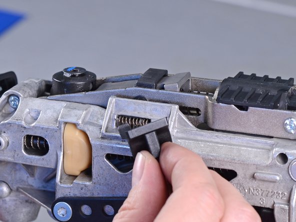

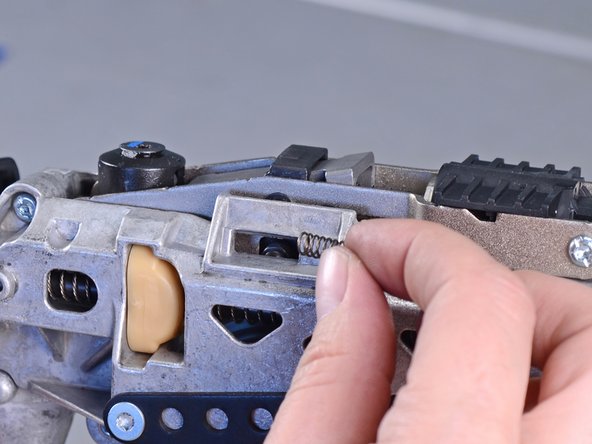

    • The spring under the release button has a tendency to fly out. Be careful not to lose the spring.
    • Carefully remove the release button from the device.
    • Remove the button spring from the device.

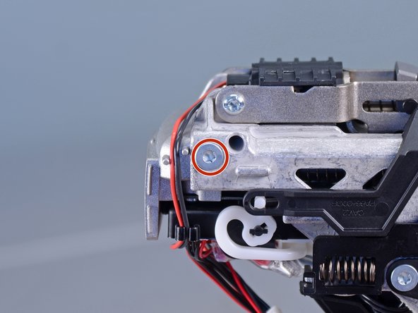

  9. Dewalt Nailers DCN680D1 2018 Driver Blade Replacement, Remove the back support: crwdns2935265:09crwdnd2935265:01crwdnd2935265:02crwdne2935265:0 Dewalt Nailers DCN680D1 2018 Driver Blade Replacement, Remove the back support: crwdns2935265:09crwdnd2935265:02crwdnd2935265:02crwdne2935265:0
    • Use a T20 driver to remove the two screws (one on either side) securing the back support .

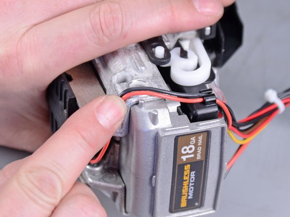

    • Loosen the two solenoid wires from the back support.

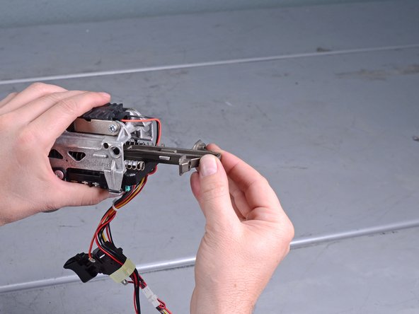

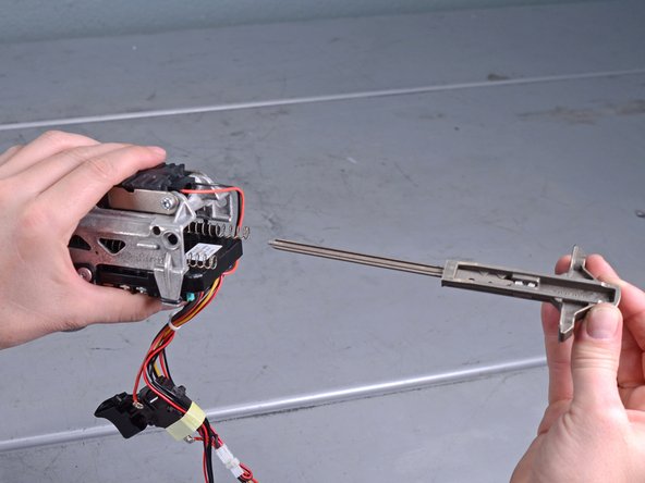

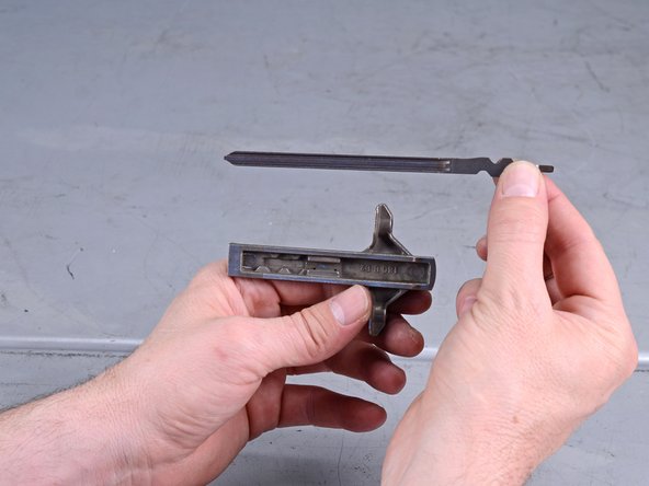

  12. Dewalt Nailers DCN680D1 2018 Driver Blade Replacement, Remove the driver assembly: crwdns2935265:012crwdnd2935265:01crwdnd2935265:03crwdne2935265:0 Dewalt Nailers DCN680D1 2018 Driver Blade Replacement, Remove the driver assembly: crwdns2935265:012crwdnd2935265:02crwdnd2935265:03crwdne2935265:0 Dewalt Nailers DCN680D1 2018 Driver Blade Replacement, Remove the driver assembly: crwdns2935265:012crwdnd2935265:03crwdnd2935265:03crwdne2935265:0
    • Grasp the driver assembly by its back and pull it straight out of the device.

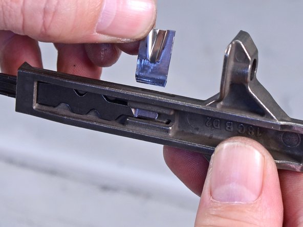

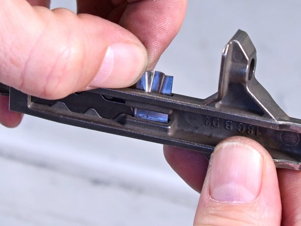

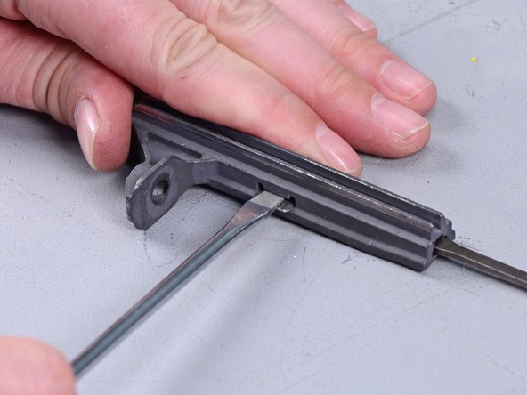

  13. Dewalt Nailers DCN680D1 2018 Driver Blade Replacement, Remove the blade: crwdns2935265:013crwdnd2935265:01crwdnd2935265:03crwdne2935265:0 Dewalt Nailers DCN680D1 2018 Driver Blade Replacement, Remove the blade: crwdns2935265:013crwdnd2935265:02crwdnd2935265:03crwdne2935265:0 Dewalt Nailers DCN680D1 2018 Driver Blade Replacement, Remove the blade: crwdns2935265:013crwdnd2935265:03crwdnd2935265:03crwdne2935265:0
    • Use pliers or a flathead screwdriver to straighten the retaining clip securing the blade.
  14. Dewalt Nailers DCN680D1 2018 Driver Blade Replacement: crwdns2935265:014crwdnd2935265:01crwdnd2935265:02crwdne2935265:0 Dewalt Nailers DCN680D1 2018 Driver Blade Replacement: crwdns2935265:014crwdnd2935265:02crwdnd2935265:02crwdne2935265:0
    • Remove the retaining clip from the driver assembly.

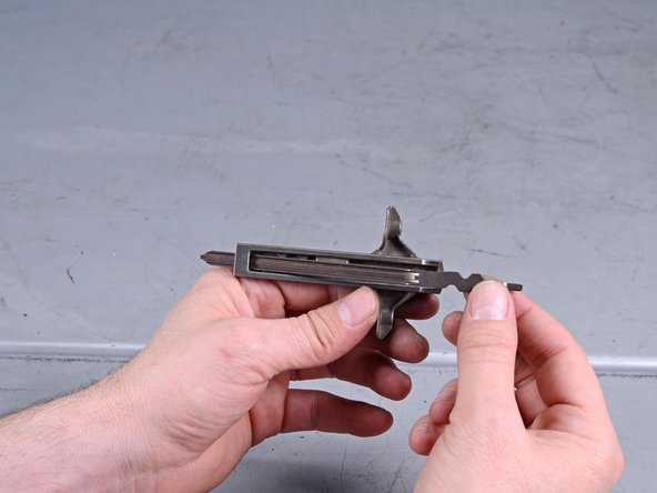

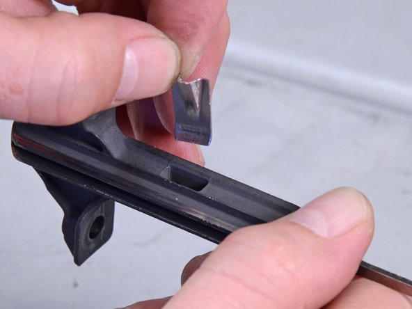

  15. Dewalt Nailers DCN680D1 2018 Driver Blade Replacement: crwdns2935265:015crwdnd2935265:01crwdnd2935265:03crwdne2935265:0 Dewalt Nailers DCN680D1 2018 Driver Blade Replacement: crwdns2935265:015crwdnd2935265:02crwdnd2935265:03crwdne2935265:0 Dewalt Nailers DCN680D1 2018 Driver Blade Replacement: crwdns2935265:015crwdnd2935265:03crwdnd2935265:03crwdne2935265:0
    • Slide the blade out of the driver assembly's slot, and remove it from the assembly.
  16. Dewalt Nailers DCN680D1 2018 Driver Blade Replacement, Install a replacement blade: crwdns2935265:016crwdnd2935265:01crwdnd2935265:03crwdne2935265:0 Dewalt Nailers DCN680D1 2018 Driver Blade Replacement, Install a replacement blade: crwdns2935265:016crwdnd2935265:02crwdnd2935265:03crwdne2935265:0 Dewalt Nailers DCN680D1 2018 Driver Blade Replacement, Install a replacement blade: crwdns2935265:016crwdnd2935265:03crwdnd2935265:03crwdne2935265:0
    • The next two steps show how to install a replacement blade into the driver assembly.
    • Slide the blade through the slot in the driver assembly and set it into the wavy groove.
    • If the blade does not sit snugly in the groove, flip the blade over and try again.
    • Insert the retaining clip oriented as shown in the photos into the driver assembly.

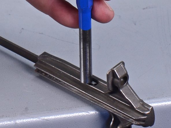

  17. Dewalt Nailers DCN680D1 2018 Driver Blade Replacement: crwdns2935265:017crwdnd2935265:01crwdnd2935265:02crwdne2935265:0 Dewalt Nailers DCN680D1 2018 Driver Blade Replacement: crwdns2935265:017crwdnd2935265:02crwdnd2935265:02crwdne2935265:0
    • Use pliers or a hammer and punch to bend the protruding end of the clip over in order to secure the blade.
