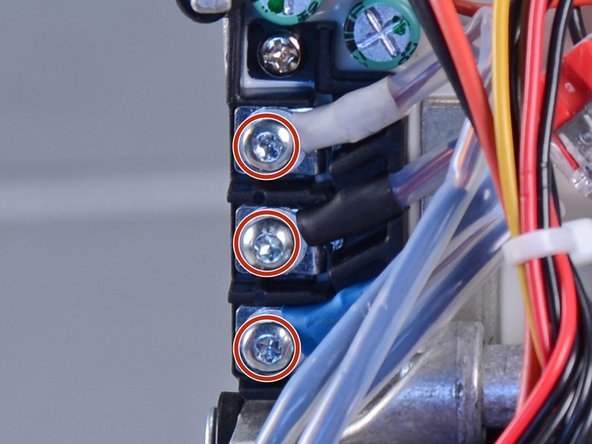

  12. Dewalt Nailers DCN680D1 2018 Control Module Replacement, Disconnect the control module: crwdns2935265:012crwdnd2935265:01crwdnd2935265:02crwdne2935265:0 Dewalt Nailers DCN680D1 2018 Control Module Replacement, Disconnect the control module: crwdns2935265:012crwdnd2935265:02crwdnd2935265:02crwdne2935265:0
    • Use a T10 driver to remove the three screws securing the motor wires
    • Reassembly tip: The motor wires are color-coded. Be sure to reconnect the motor wires as shown in the photo.

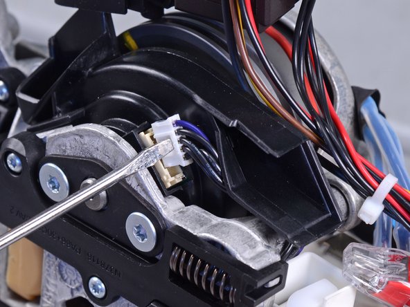

  13. Dewalt Nailers DCN680D1 2018 Control Module Replacement: crwdns2935265:013crwdnd2935265:01crwdnd2935265:02crwdne2935265:0 Dewalt Nailers DCN680D1 2018 Control Module Replacement: crwdns2935265:013crwdnd2935265:02crwdnd2935265:02crwdne2935265:0
    • Use a small flathead screwdriver to pry up and disconnect the sensor connector from the side of the motor.

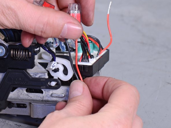

    • Insert the point of a pick tool into the push-in connector's inlet hole, which has the control module wire plugged into it.
    • Make sure you choose the inlet that connects to the control module, not the solenoid.
  15. Dewalt Nailers DCN680D1 2018 Control Module Replacement: crwdns2935265:015crwdnd2935265:01crwdnd2935265:02crwdne2935265:0 Dewalt Nailers DCN680D1 2018 Control Module Replacement: crwdns2935265:015crwdnd2935265:02crwdnd2935265:02crwdne2935265:0
    • With the pick tool still inserted, pull the red control module wire out of the push-in connector.
  16. Dewalt Nailers DCN680D1 2018 Control Module Replacement: crwdns2935265:016crwdnd2935265:01crwdnd2935265:01crwdne2935265:0
    • Repeat the previous two steps to disconnect the black control module wire from the push-in connector.
  17. Dewalt Nailers DCN680D1 2018 Control Module Replacement: crwdns2935265:017crwdnd2935265:01crwdnd2935265:02crwdne2935265:0 Dewalt Nailers DCN680D1 2018 Control Module Replacement: crwdns2935265:017crwdnd2935265:02crwdnd2935265:02crwdne2935265:0
    • Unclip the solenoid's red and black wires from the control module's side.

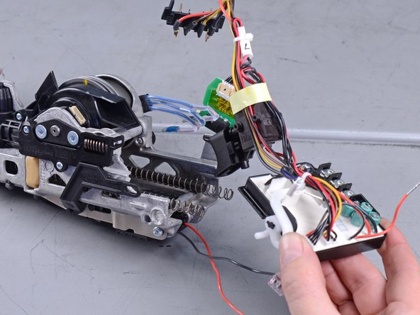

  18. Dewalt Nailers DCN680D1 2018 Control Module Replacement, Remove the control module: crwdns2935265:018crwdnd2935265:01crwdnd2935265:03crwdne2935265:0 Dewalt Nailers DCN680D1 2018 Control Module Replacement, Remove the control module: crwdns2935265:018crwdnd2935265:02crwdnd2935265:03crwdne2935265:0 Dewalt Nailers DCN680D1 2018 Control Module Replacement, Remove the control module: crwdns2935265:018crwdnd2935265:03crwdnd2935265:03crwdne2935265:0
    • Lift and remove the control module from the device.

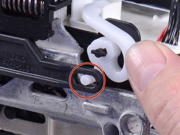

    • Reassembly tip: Make sure that the white plastic actuator latches into the black lever arm.
  19. Dewalt Nailers DCN680D1 2018 Control Module Replacement, Transfer the loose components: crwdns2935265:019crwdnd2935265:01crwdnd2935265:03crwdne2935265:0 Dewalt Nailers DCN680D1 2018 Control Module Replacement, Transfer the loose components: crwdns2935265:019crwdnd2935265:02crwdnd2935265:03crwdne2935265:0 Dewalt Nailers DCN680D1 2018 Control Module Replacement, Transfer the loose components: crwdns2935265:019crwdnd2935265:03crwdnd2935265:03crwdne2935265:0
    • Remove the white plastic actuator from the control module and transfer it onto your replacement part.
    • When you install the actuator, make sure the actuator bar can press the white button on the control module.
