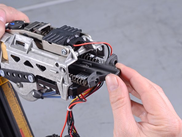

  13. Dewalt Nailers DCN660D1 2018 Driver Blade Replacement, Remove the driver assembly: crwdns2935265:013crwdnd2935265:01crwdnd2935265:03crwdne2935265:0 Dewalt Nailers DCN660D1 2018 Driver Blade Replacement, Remove the driver assembly: crwdns2935265:013crwdnd2935265:02crwdnd2935265:03crwdne2935265:0 Dewalt Nailers DCN660D1 2018 Driver Blade Replacement, Remove the driver assembly: crwdns2935265:013crwdnd2935265:03crwdnd2935265:03crwdne2935265:0
    • Grasp the driver assembly by its back and pull it straight out of the device.
    • If you are having trouble pulling the driver assembly out, proceed to the next step.

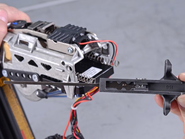

  15. Dewalt Nailers DCN660D1 2018 Driver Blade Replacement, Remove the blade: crwdns2935265:015crwdnd2935265:01crwdnd2935265:03crwdne2935265:0 Dewalt Nailers DCN660D1 2018 Driver Blade Replacement, Remove the blade: crwdns2935265:015crwdnd2935265:02crwdnd2935265:03crwdne2935265:0 Dewalt Nailers DCN660D1 2018 Driver Blade Replacement, Remove the blade: crwdns2935265:015crwdnd2935265:03crwdnd2935265:03crwdne2935265:0
    • Use pliers or a flathead screwdriver to straighten the retaining clip securing the blade.
  16. Dewalt Nailers DCN660D1 2018 Driver Blade Replacement: crwdns2935265:016crwdnd2935265:01crwdnd2935265:02crwdne2935265:0 Dewalt Nailers DCN660D1 2018 Driver Blade Replacement: crwdns2935265:016crwdnd2935265:02crwdnd2935265:02crwdne2935265:0
    • Remove the retaining clip from the driver assembly.
  17. Dewalt Nailers DCN660D1 2018 Driver Blade Replacement: crwdns2935265:017crwdnd2935265:01crwdnd2935265:03crwdne2935265:0 Dewalt Nailers DCN660D1 2018 Driver Blade Replacement: crwdns2935265:017crwdnd2935265:02crwdnd2935265:03crwdne2935265:0 Dewalt Nailers DCN660D1 2018 Driver Blade Replacement: crwdns2935265:017crwdnd2935265:03crwdnd2935265:03crwdne2935265:0
    • Slide the blade out of the driver assembly's slot, and remove it from the assembly.
  18. Dewalt Nailers DCN660D1 2018 Driver Blade Replacement, Install a replacement blade: crwdns2935265:018crwdnd2935265:01crwdnd2935265:03crwdne2935265:0 Dewalt Nailers DCN660D1 2018 Driver Blade Replacement, Install a replacement blade: crwdns2935265:018crwdnd2935265:02crwdnd2935265:03crwdne2935265:0 Dewalt Nailers DCN660D1 2018 Driver Blade Replacement, Install a replacement blade: crwdns2935265:018crwdnd2935265:03crwdnd2935265:03crwdne2935265:0
    • The next two steps show how to install a replacement blade into the driver assembly.
    • Slide the blade through the slot in the driver assembly and set it into the wavy groove.
    • If the blade does not sit snugly in the groove, flip the blade over and try again.
    • Insert the retaining clip oriented as shown in the photos into the driver assembly.

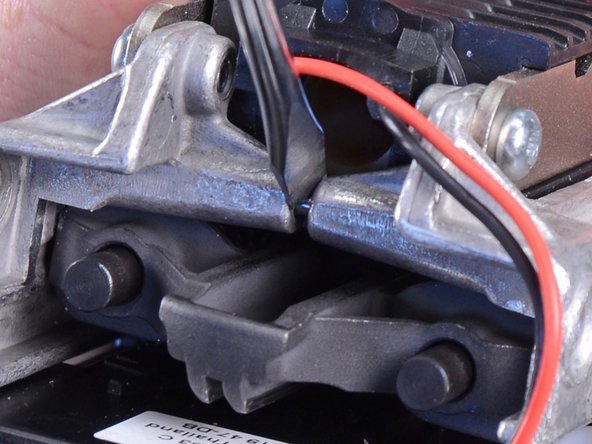

  19. Dewalt Nailers DCN660D1 2018 Driver Blade Replacement: crwdns2935265:019crwdnd2935265:01crwdnd2935265:02crwdne2935265:0 Dewalt Nailers DCN660D1 2018 Driver Blade Replacement: crwdns2935265:019crwdnd2935265:02crwdnd2935265:02crwdne2935265:0
    • Use pliers or a hammer and punch to bend the protruding end of the clip over in order to secure the blade.
