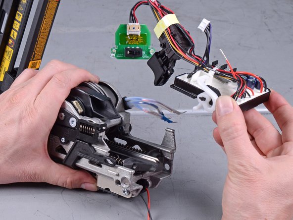

  7. Dewalt Nailers DCN660D1 2018 Control Module Replacement, Reassembly tip: crwdns2935265:07crwdnd2935265:01crwdnd2935265:03crwdne2935265:0 Dewalt Nailers DCN660D1 2018 Control Module Replacement, Reassembly tip: crwdns2935265:07crwdnd2935265:02crwdnd2935265:03crwdne2935265:0 Dewalt Nailers DCN660D1 2018 Control Module Replacement, Reassembly tip: crwdns2935265:07crwdnd2935265:03crwdnd2935265:03crwdne2935265:0
    • During reassembly, use these photos to help you align all the loose parts back into the housing.
    • Be sure to route the wires through the yellow groove.
    • Be sure to reattach the spring clips.

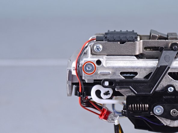

  10. Dewalt Nailers DCN660D1 2018 Control Module Replacement, Remove the back support: crwdns2935265:010crwdnd2935265:01crwdnd2935265:02crwdne2935265:0 Dewalt Nailers DCN660D1 2018 Control Module Replacement, Remove the back support: crwdns2935265:010crwdnd2935265:02crwdnd2935265:02crwdne2935265:0
    • Use a T25 driver to remove the two screws (one on either side) securing the back support .

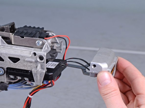

  11. Dewalt Nailers DCN660D1 2018 Control Module Replacement: crwdns2935265:011crwdnd2935265:01crwdnd2935265:02crwdne2935265:0 Dewalt Nailers DCN660D1 2018 Control Module Replacement: crwdns2935265:011crwdnd2935265:02crwdnd2935265:02crwdne2935265:0
    • Loosen the two solenoid wires from the back support.
  12. Dewalt Nailers DCN660D1 2018 Control Module Replacement: crwdns2935265:012crwdnd2935265:01crwdnd2935265:02crwdne2935265:0 Dewalt Nailers DCN660D1 2018 Control Module Replacement: crwdns2935265:012crwdnd2935265:02crwdnd2935265:02crwdne2935265:0
    • Pull the back support straight out of the device.

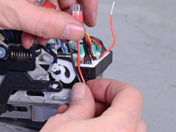

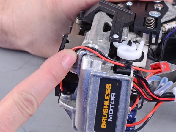

  13. Dewalt Nailers DCN660D1 2018 Control Module Replacement, Disconnect the control module: crwdns2935265:013crwdnd2935265:01crwdnd2935265:01crwdne2935265:0
    • Use a T10 driver to remove the three screws securing the motor wires
    • Reassembly tip: The motor wires are color-coded. Be sure to reconnect the motor wires as shown in the photo.

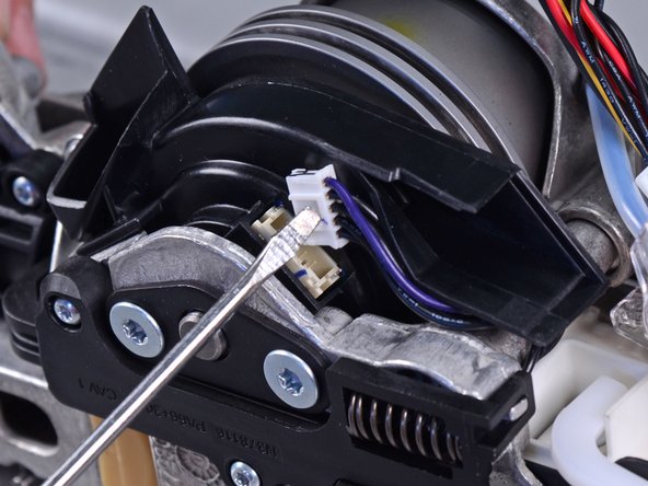

  14. Dewalt Nailers DCN660D1 2018 Control Module Replacement: crwdns2935265:014crwdnd2935265:01crwdnd2935265:02crwdne2935265:0 Dewalt Nailers DCN660D1 2018 Control Module Replacement: crwdns2935265:014crwdnd2935265:02crwdnd2935265:02crwdne2935265:0
    • Use a small flathead screwdriver to pry up and disconnect the sensor connector from the side of the motor.

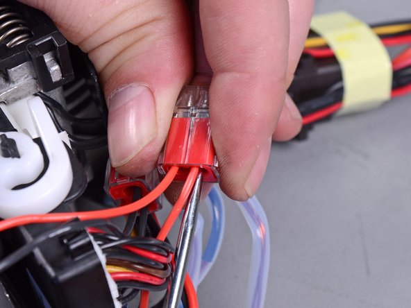

  15. Dewalt Nailers DCN660D1 2018 Control Module Replacement: crwdns2935265:015crwdnd2935265:01crwdnd2935265:02crwdne2935265:0 Dewalt Nailers DCN660D1 2018 Control Module Replacement: crwdns2935265:015crwdnd2935265:02crwdnd2935265:02crwdne2935265:0

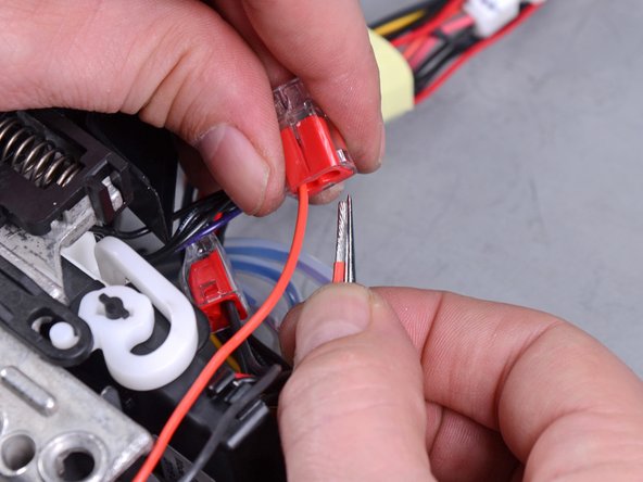

    • Insert the point of a pick tool into the push-in connector's inlet hole, which has the control module wire plugged into it.
    • Make sure you choose the inlet that connects to the control module, not the solenoid.
  16. Dewalt Nailers DCN660D1 2018 Control Module Replacement: crwdns2935265:016crwdnd2935265:01crwdnd2935265:02crwdne2935265:0 Dewalt Nailers DCN660D1 2018 Control Module Replacement: crwdns2935265:016crwdnd2935265:02crwdnd2935265:02crwdne2935265:0
    • With the pick tool still inserted, pull the red control module wire out of the push-in connector.
  17. Dewalt Nailers DCN660D1 2018 Control Module Replacement: crwdns2935265:017crwdnd2935265:01crwdnd2935265:01crwdne2935265:0
    • Repeat the previous two steps to disconnect the black control module wire from the push-in connector.

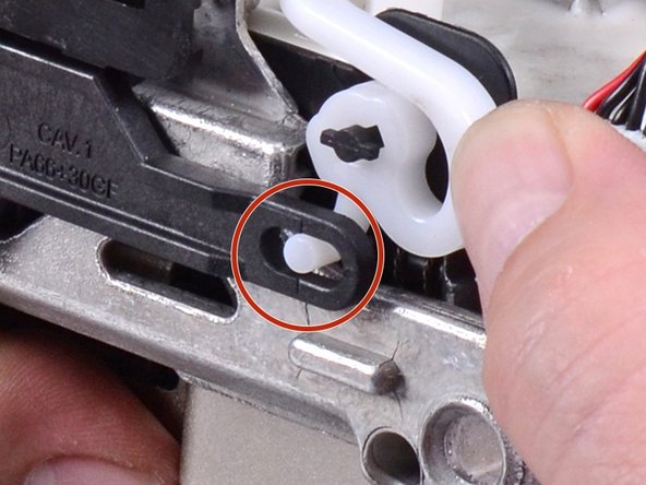

  19. Dewalt Nailers DCN660D1 2018 Control Module Replacement, Remove the control module: crwdns2935265:019crwdnd2935265:01crwdnd2935265:03crwdne2935265:0 Dewalt Nailers DCN660D1 2018 Control Module Replacement, Remove the control module: crwdns2935265:019crwdnd2935265:02crwdnd2935265:03crwdne2935265:0 Dewalt Nailers DCN660D1 2018 Control Module Replacement, Remove the control module: crwdns2935265:019crwdnd2935265:03crwdnd2935265:03crwdne2935265:0
    • Lift and remove the control module from the device.
    • Reassembly tip: Make sure that the white plastic actuator latches into the black lever arm.

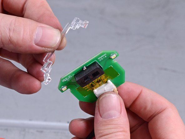

  21. Dewalt Nailers DCN660D1 2018 Control Module Replacement: crwdns2935265:021crwdnd2935265:01crwdnd2935265:02crwdne2935265:0 Dewalt Nailers DCN660D1 2018 Control Module Replacement: crwdns2935265:021crwdnd2935265:02crwdnd2935265:02crwdne2935265:0
    • Carefully unclip the clear light pipe from the switch board.
    • The light pipe is fragile and breaks easily.
    • Transfer the light pipe onto your replacement part.
