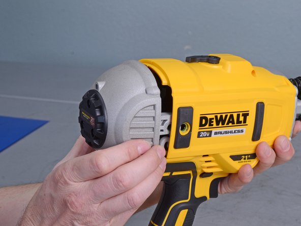

  4. Dewalt Nailers DCN21PL 2018 Solenoid Assembly Replacement: crwdns2935265:04crwdnd2935265:01crwdnd2935265:02crwdne2935265:0 Dewalt Nailers DCN21PL 2018 Solenoid Assembly Replacement: crwdns2935265:04crwdnd2935265:02crwdnd2935265:02crwdne2935265:0
    • Pull the magazine down and away to unlatch and release it from the nailer.

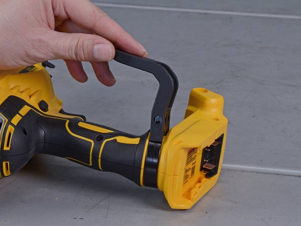

  5. Dewalt Nailers DCN21PL 2018 Solenoid Assembly Replacement, Remove framing hook: crwdns2935265:05crwdnd2935265:01crwdnd2935265:03crwdne2935265:0 Dewalt Nailers DCN21PL 2018 Solenoid Assembly Replacement, Remove framing hook: crwdns2935265:05crwdnd2935265:02crwdnd2935265:03crwdne2935265:0 Dewalt Nailers DCN21PL 2018 Solenoid Assembly Replacement, Remove framing hook: crwdns2935265:05crwdnd2935265:03crwdnd2935265:03crwdne2935265:0
    • Use a T15 driver to remove the framing hook retaining screw.
    • Remove the hook.

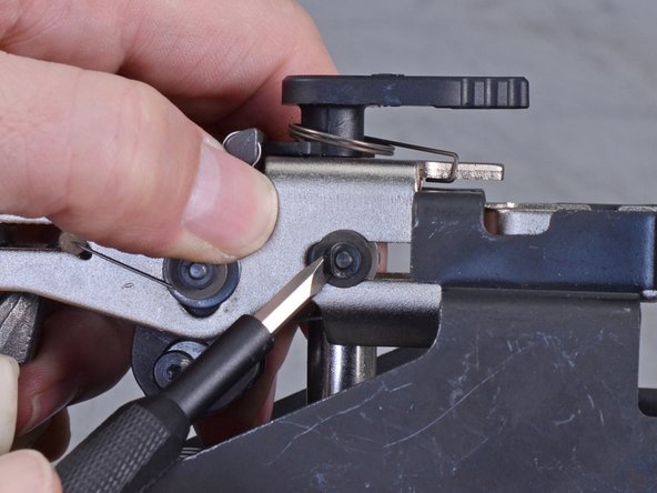

  6. Dewalt Nailers DCN21PL 2018 Solenoid Assembly Replacement, Remove hook clamp: crwdns2935265:06crwdnd2935265:01crwdnd2935265:01crwdne2935265:0
    • This step may require a lot of force.
    • Use your two thumbs to firmly spread the metal hook clamp apart while slowly pushing it forward off the handle.
    • When this clamp is being removed, it has a tendency to launch off of the handle after you release tension.

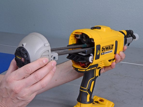

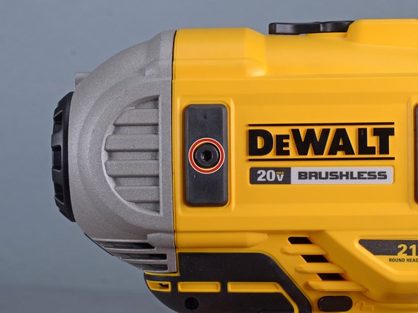

  9. Dewalt Nailers DCN21PL 2018 Solenoid Assembly Replacement, Remove return system: crwdns2935265:09crwdnd2935265:01crwdnd2935265:02crwdne2935265:0 Dewalt Nailers DCN21PL 2018 Solenoid Assembly Replacement, Remove return system: crwdns2935265:09crwdnd2935265:02crwdnd2935265:02crwdne2935265:0
    • Use the provided 3.5 mm hex key to remove the two return system bolts on either side of the nailer.
  10. Dewalt Nailers DCN21PL 2018 Solenoid Assembly Replacement: crwdns2935265:010crwdnd2935265:01crwdnd2935265:03crwdne2935265:0 Dewalt Nailers DCN21PL 2018 Solenoid Assembly Replacement: crwdns2935265:010crwdnd2935265:02crwdnd2935265:03crwdne2935265:0 Dewalt Nailers DCN21PL 2018 Solenoid Assembly Replacement: crwdns2935265:010crwdnd2935265:03crwdnd2935265:03crwdne2935265:0
    • Grab the end cap and slide the return system assembly out of the back of the nailer to remove it.

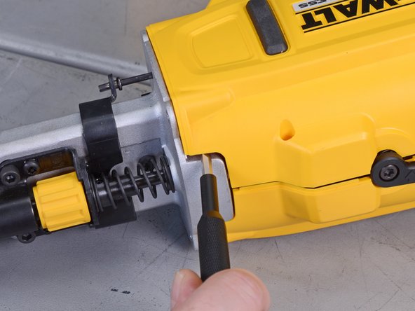

  11. Dewalt Nailers DCN21PL 2018 Solenoid Assembly Replacement: crwdns2935265:011crwdnd2935265:01crwdnd2935265:02crwdne2935265:0 Dewalt Nailers DCN21PL 2018 Solenoid Assembly Replacement: crwdns2935265:011crwdnd2935265:02crwdnd2935265:02crwdne2935265:0

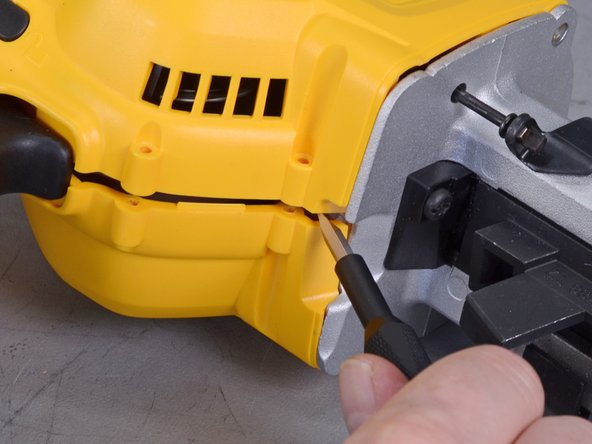

    • Use a small flathead screwdriver in the gap between the two halves of the casing near the trigger to pry the two halves apart.
  12. Dewalt Nailers DCN21PL 2018 Solenoid Assembly Replacement: crwdns2935265:012crwdnd2935265:01crwdnd2935265:02crwdne2935265:0 Dewalt Nailers DCN21PL 2018 Solenoid Assembly Replacement: crwdns2935265:012crwdnd2935265:02crwdnd2935265:02crwdne2935265:0
    • Use a small flathead screwdriver near the top seam to continue prying the case apart .

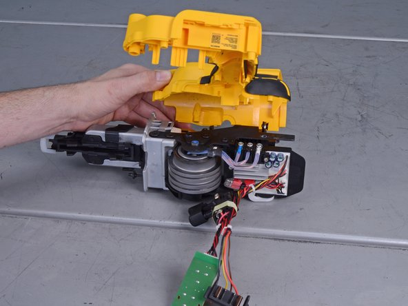

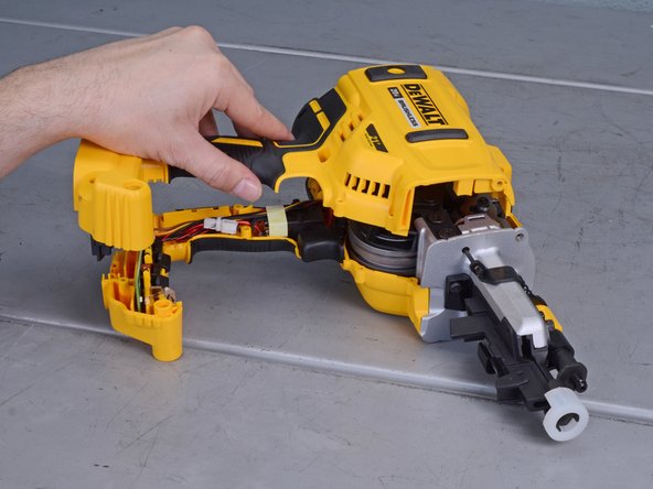

  13. Dewalt Nailers DCN21PL 2018 Solenoid Assembly Replacement, Remove right half of case: crwdns2935265:013crwdnd2935265:01crwdnd2935265:02crwdne2935265:0 Dewalt Nailers DCN21PL 2018 Solenoid Assembly Replacement, Remove right half of case: crwdns2935265:013crwdnd2935265:02crwdnd2935265:02crwdne2935265:0
    • Once loose, lift up to remove the right half of the clamshell case.

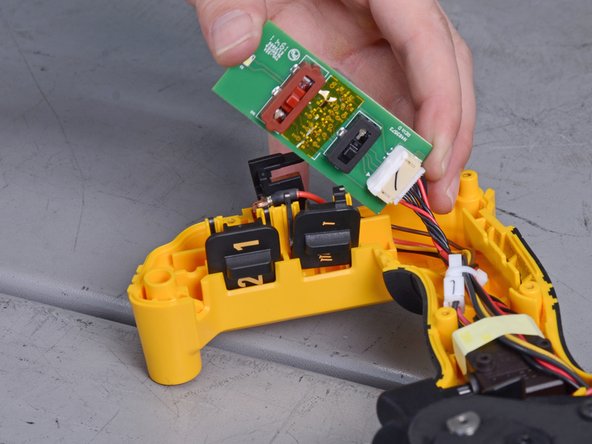

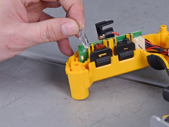

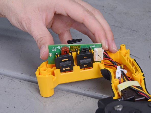

  15. Dewalt Nailers DCN21PL 2018 Solenoid Assembly Replacement, Remove board and switches: crwdns2935265:015crwdnd2935265:01crwdnd2935265:03crwdne2935265:0 Dewalt Nailers DCN21PL 2018 Solenoid Assembly Replacement, Remove board and switches: crwdns2935265:015crwdnd2935265:02crwdnd2935265:03crwdne2935265:0 Dewalt Nailers DCN21PL 2018 Solenoid Assembly Replacement, Remove board and switches: crwdns2935265:015crwdnd2935265:03crwdnd2935265:03crwdne2935265:0
    • The two switches and four detent springs are only held in place by the plastic casing, so they may fall out when you remove the board—this is fine.
    • Grasp either side of the main circuit board and slowly pull it up and out of the slot in the casing.
    • Reassembly tip: note the correct location and orientation of the two switches and their detent springs.

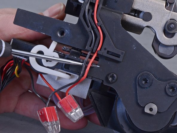

  18. Dewalt Nailers DCN21PL 2018 Solenoid Assembly Replacement, Remove solenoid wires: crwdns2935265:018crwdnd2935265:01crwdnd2935265:02crwdne2935265:0 Dewalt Nailers DCN21PL 2018 Solenoid Assembly Replacement, Remove solenoid wires: crwdns2935265:018crwdnd2935265:02crwdnd2935265:02crwdne2935265:0
    • Carefully use a pick tool to release the black and red wires from their routing guide on the nailer.

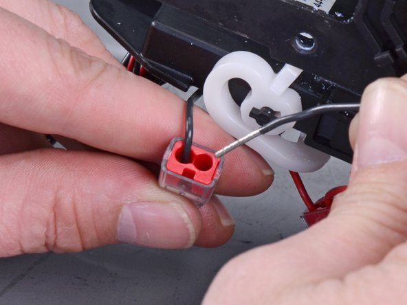

  19. Dewalt Nailers DCN21PL 2018 Solenoid Assembly Replacement: crwdns2935265:019crwdnd2935265:01crwdnd2935265:02crwdne2935265:0 Dewalt Nailers DCN21PL 2018 Solenoid Assembly Replacement: crwdns2935265:019crwdnd2935265:02crwdnd2935265:02crwdne2935265:0
    • Insert the point of a pick tool into the push-in connector's inlet hole, which has the solenoid wire plugged into it.
    • With the pick tool still inserted, pull the red solenoid wire out of the push-in connector.
    • Make sure you choose the inlet that connects to the solenoid, not the main board.
    • Repeat this same process for the black wire and other push-in connector.
    • Fully remove both wires from the wire guide.

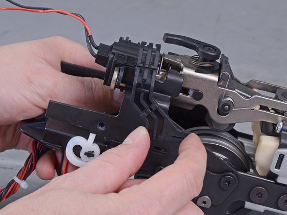

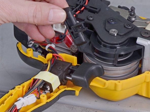

  20. Dewalt Nailers DCN21PL 2018 Solenoid Assembly Replacement, Remove wire guide: crwdns2935265:020crwdnd2935265:01crwdnd2935265:03crwdne2935265:0 Dewalt Nailers DCN21PL 2018 Solenoid Assembly Replacement, Remove wire guide: crwdns2935265:020crwdnd2935265:02crwdnd2935265:03crwdne2935265:0 Dewalt Nailers DCN21PL 2018 Solenoid Assembly Replacement, Remove wire guide: crwdns2935265:020crwdnd2935265:03crwdnd2935265:03crwdne2935265:0
    • Pull out and up on the plastic wire guide to disconnect it from its clips.
    • Detach and remove the wire guide.

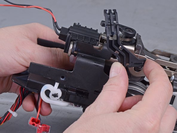

  21. Dewalt Nailers DCN21PL 2018 Solenoid Assembly Replacement, Remove solenoid body: crwdns2935265:021crwdnd2935265:01crwdnd2935265:02crwdne2935265:0 Dewalt Nailers DCN21PL 2018 Solenoid Assembly Replacement, Remove solenoid body: crwdns2935265:021crwdnd2935265:02crwdnd2935265:02crwdne2935265:0
    • This step may require a lot of force, as the solenoid is secured by a pressure fit.
    • Pull directly back on the solenoid to remove it from the mount. You may have to "walk" the solenoid back and forth to slowly loosen it from the slots holding it in place.

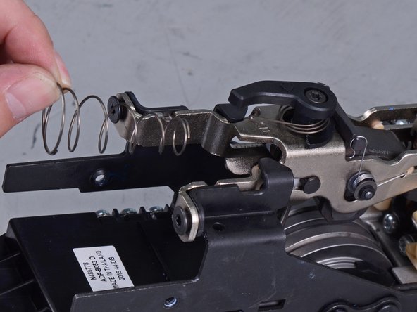

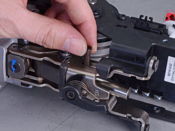

  22. Dewalt Nailers DCN21PL 2018 Solenoid Assembly Replacement, Remove solenoid assembly components: crwdns2935265:022crwdnd2935265:01crwdnd2935265:02crwdne2935265:0 Dewalt Nailers DCN21PL 2018 Solenoid Assembly Replacement, Remove solenoid assembly components: crwdns2935265:022crwdnd2935265:02crwdnd2935265:02crwdne2935265:0
    • Remove the solenoid pin spring.
  23. Dewalt Nailers DCN21PL 2018 Solenoid Assembly Replacement: crwdns2935265:023crwdnd2935265:01crwdnd2935265:02crwdne2935265:0 Dewalt Nailers DCN21PL 2018 Solenoid Assembly Replacement: crwdns2935265:023crwdnd2935265:02crwdnd2935265:02crwdne2935265:0
    • Use as small flat head screwdriver to pry the rubber washer off the retaining pin.
  24. Dewalt Nailers DCN21PL 2018 Solenoid Assembly Replacement: crwdns2935265:024crwdnd2935265:01crwdnd2935265:02crwdne2935265:0 Dewalt Nailers DCN21PL 2018 Solenoid Assembly Replacement: crwdns2935265:024crwdnd2935265:02crwdnd2935265:02crwdne2935265:0
    • Remove the rubber washer from the retaining pin.
    • Remove the metal washer.

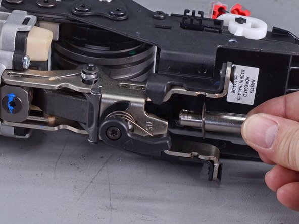

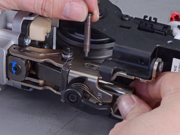

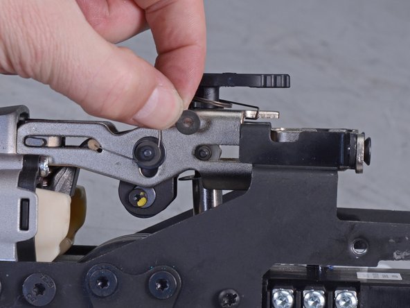

  25. Dewalt Nailers DCN21PL 2018 Solenoid Assembly Replacement: crwdns2935265:025crwdnd2935265:01crwdnd2935265:03crwdne2935265:0 Dewalt Nailers DCN21PL 2018 Solenoid Assembly Replacement: crwdns2935265:025crwdnd2935265:02crwdnd2935265:03crwdne2935265:0 Dewalt Nailers DCN21PL 2018 Solenoid Assembly Replacement: crwdns2935265:025crwdnd2935265:03crwdnd2935265:03crwdne2935265:0
    • Lay the nailer on its side with the flat side of the pin facing up. Pull the retaining pin directly up out of the slot to remove.
    • Use your opposite hand to hold the main solenoid plunger to prevent it from falling.
  26. Dewalt Nailers DCN21PL 2018 Solenoid Assembly Replacement: crwdns2935265:026crwdnd2935265:01crwdnd2935265:02crwdne2935265:0 Dewalt Nailers DCN21PL 2018 Solenoid Assembly Replacement: crwdns2935265:026crwdnd2935265:02crwdnd2935265:02crwdne2935265:0
    • Remove the solenoid plunger and small solenoid washer.
