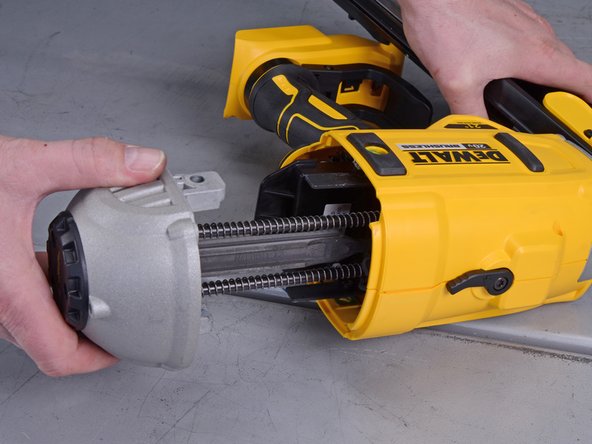

  3. Dewalt Nailers DCN21PL 2018 Profile Replacement: crwdns2935265:03crwdnd2935265:01crwdnd2935265:02crwdne2935265:0 Dewalt Nailers DCN21PL 2018 Profile Replacement: crwdns2935265:03crwdnd2935265:02crwdnd2935265:02crwdne2935265:0
    • Pull the end cap away from the nailer to remove the return system assembly.

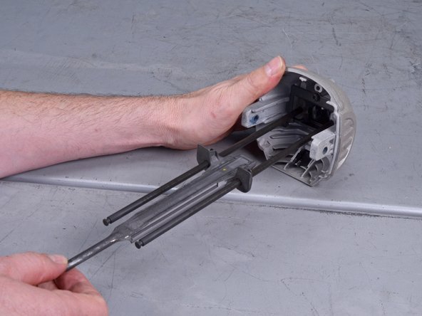

    • Reassembly tip: make sure the rails slide into their correct guide holes.

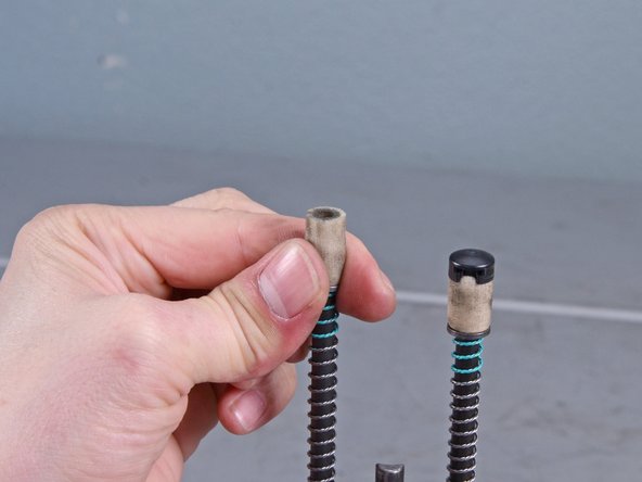

  4. Dewalt Nailers DCN21PL 2018 Profile Replacement, Remove rail clips: crwdns2935265:04crwdnd2935265:01crwdnd2935265:02crwdne2935265:0 Dewalt Nailers DCN21PL 2018 Profile Replacement, Remove rail clips: crwdns2935265:04crwdnd2935265:02crwdnd2935265:02crwdne2935265:0
    • Use your thumbs to pull the spring bumpers just far enough away from the rail clips so they aren't touching.

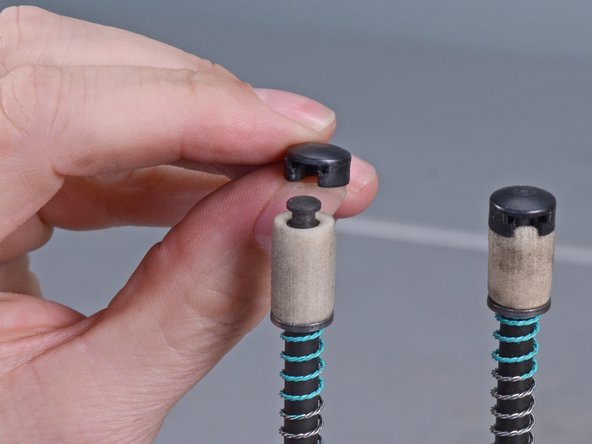

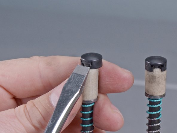

  5. Dewalt Nailers DCN21PL 2018 Profile Replacement: crwdns2935265:05crwdnd2935265:01crwdnd2935265:03crwdne2935265:0 Dewalt Nailers DCN21PL 2018 Profile Replacement: crwdns2935265:05crwdnd2935265:02crwdnd2935265:03crwdne2935265:0 Dewalt Nailers DCN21PL 2018 Profile Replacement: crwdns2935265:05crwdnd2935265:03crwdnd2935265:03crwdne2935265:0
    • Use a large flathead screwdriver to slide the rail clip off of the tip of the rail.
    • Remove the rail clip.

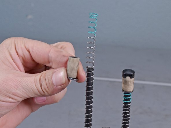

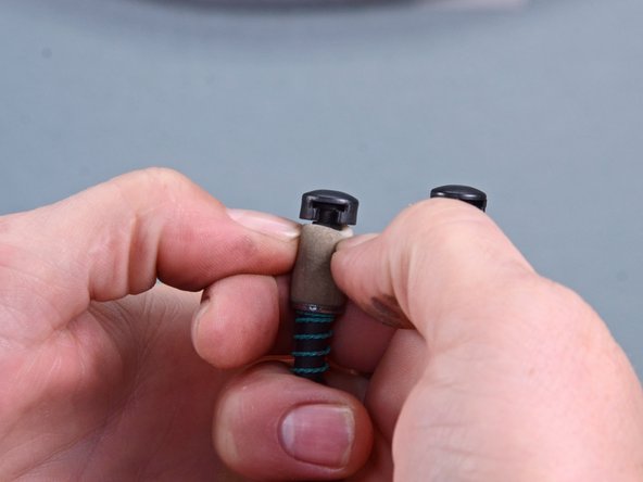

  6. Dewalt Nailers DCN21PL 2018 Profile Replacement, Remove spring bumpers: crwdns2935265:06crwdnd2935265:01crwdnd2935265:03crwdne2935265:0 Dewalt Nailers DCN21PL 2018 Profile Replacement, Remove spring bumpers: crwdns2935265:06crwdnd2935265:02crwdnd2935265:03crwdne2935265:0 Dewalt Nailers DCN21PL 2018 Profile Replacement, Remove spring bumpers: crwdns2935265:06crwdnd2935265:03crwdnd2935265:03crwdne2935265:0
    • Firmly grasp the spring bumper. Pull up while twisting to remove it from the rail.
    • Remove the spring bumper and accompanying washer.
    • Repeat Steps 4-6 for the other rail.

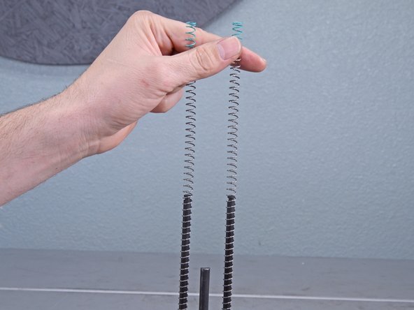

  7. Dewalt Nailers DCN21PL 2018 Profile Replacement, Remove springs: crwdns2935265:07crwdnd2935265:01crwdnd2935265:02crwdne2935265:0 Dewalt Nailers DCN21PL 2018 Profile Replacement, Remove springs: crwdns2935265:07crwdnd2935265:02crwdnd2935265:02crwdne2935265:0
    • Pull both springs directly up off the rails to remove.
  8. Dewalt Nailers DCN21PL 2018 Profile Replacement, Remove profile: crwdns2935265:08crwdnd2935265:01crwdnd2935265:03crwdne2935265:0 Dewalt Nailers DCN21PL 2018 Profile Replacement, Remove profile: crwdns2935265:08crwdnd2935265:02crwdnd2935265:03crwdne2935265:0 Dewalt Nailers DCN21PL 2018 Profile Replacement, Remove profile: crwdns2935265:08crwdnd2935265:03crwdnd2935265:03crwdne2935265:0
    • With the rails clear, the profile can now slide off. Pull the profile off the rails to remove.
