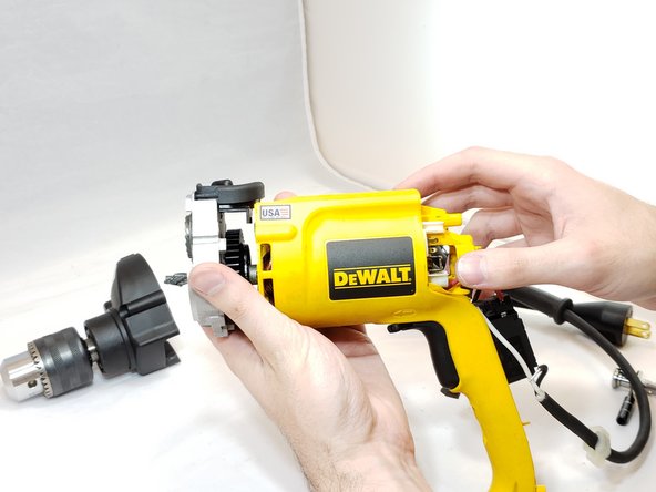

  11. Dewalt DW511 Hammer Drill Motor Replacement: crwdns2935265:011crwdnd2935265:01crwdnd2935265:03crwdne2935265:0 Dewalt DW511 Hammer Drill Motor Replacement: crwdns2935265:011crwdnd2935265:02crwdnd2935265:03crwdne2935265:0 Dewalt DW511 Hammer Drill Motor Replacement: crwdns2935265:011crwdnd2935265:03crwdnd2935265:03crwdne2935265:0
    • Grab the gear case cover and gently pull it out just enough to where it exposes the lever assembly.
    • It is important that the brushes are removed before you do this step or you may damage your brushes.
    • The lever assembly can now be lifted out.

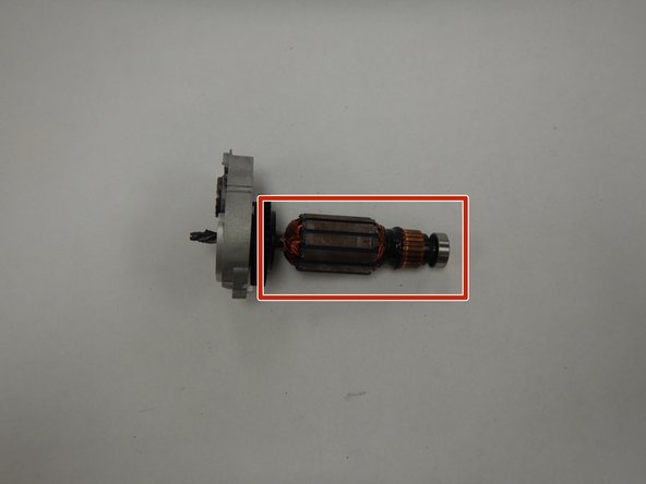

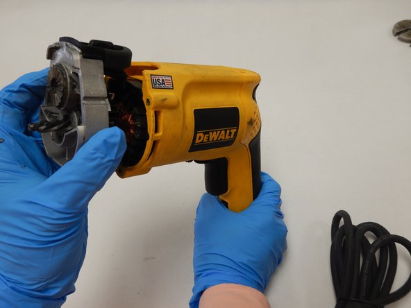

  13. Dewalt DW511 Hammer Drill Motor Replacement, Motor: crwdns2935265:013crwdnd2935265:01crwdnd2935265:03crwdne2935265:0 Dewalt DW511 Hammer Drill Motor Replacement, Motor: crwdns2935265:013crwdnd2935265:02crwdnd2935265:03crwdne2935265:0 Dewalt DW511 Hammer Drill Motor Replacement, Motor: crwdns2935265:013crwdnd2935265:03crwdnd2935265:03crwdne2935265:0
    • Hold the hammer drill tool firmly by the handle.
    • Gently separate the gear case unit from the hammer drill body.
  14. Dewalt DW511 Hammer Drill Motor Replacement: crwdns2935265:014crwdnd2935265:01crwdnd2935265:02crwdne2935265:0 Dewalt DW511 Hammer Drill Motor Replacement: crwdns2935265:014crwdnd2935265:02crwdnd2935265:02crwdne2935265:0
    • The motor is attached to the metallic alloy gear case and removes as a unit. Separation of the motor from the gear case requires specialized hand tools.
