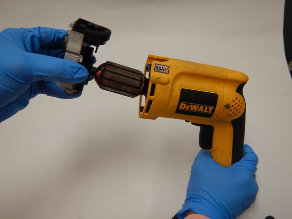

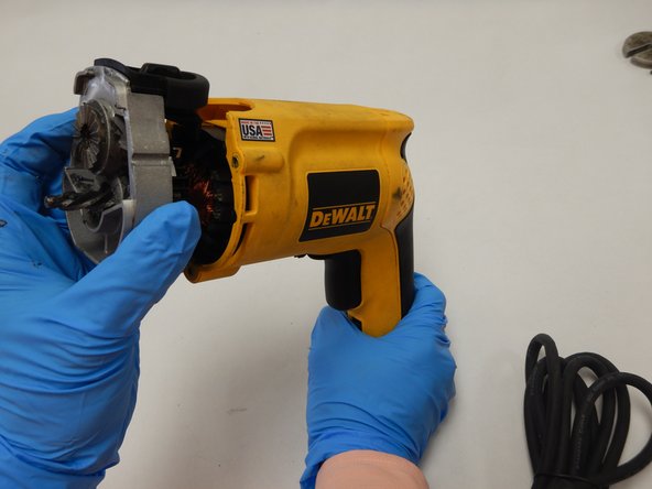

  13. Dewalt DW511 Hammer Drill Gearcase Replacement, Gearcase: crwdns2935265:013crwdnd2935265:01crwdnd2935265:03crwdne2935265:0 Dewalt DW511 Hammer Drill Gearcase Replacement, Gearcase: crwdns2935265:013crwdnd2935265:02crwdnd2935265:03crwdne2935265:0 Dewalt DW511 Hammer Drill Gearcase Replacement, Gearcase: crwdns2935265:013crwdnd2935265:03crwdnd2935265:03crwdne2935265:0
    • Hold the hammer drill tool firmly by the handle.
    • Gently separate the gear case unit from the hammer drill body.
  14. Dewalt DW511 Hammer Drill Gearcase Replacement: crwdns2935265:014crwdnd2935265:01crwdnd2935265:03crwdne2935265:0 Dewalt DW511 Hammer Drill Gearcase Replacement: crwdns2935265:014crwdnd2935265:02crwdnd2935265:03crwdne2935265:0 Dewalt DW511 Hammer Drill Gearcase Replacement: crwdns2935265:014crwdnd2935265:03crwdnd2935265:03crwdne2935265:0
    • The metallic alloy gear case is attached to the armature and removes as a unit. Separation of the gear case from the armature requires specialized hand tools.
    • The third photo shows a gear behind the chuck that interlocks to the gear case.
    • The plastic housing is prone to damage if excessive force is applied during the removal of the gear.
