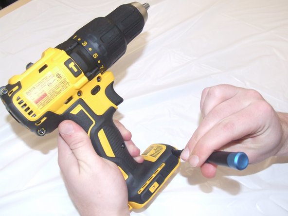

      • Grab the drill in one hand and cup the battery (located at the bottom of the drill) with the other hand.
    2. Dewalt DCD778 Motor Replacement: crwdns2935265:02crwdnd2935265:01crwdnd2935265:01crwdne2935265:0
      • Use your other hand to push down on the yellow button on the battery.
    3. Dewalt DCD778 Motor Replacement: crwdns2935265:03crwdnd2935265:01crwdnd2935265:01crwdne2935265:0
      • Pull the battery in a horizontal direction away from the drill.

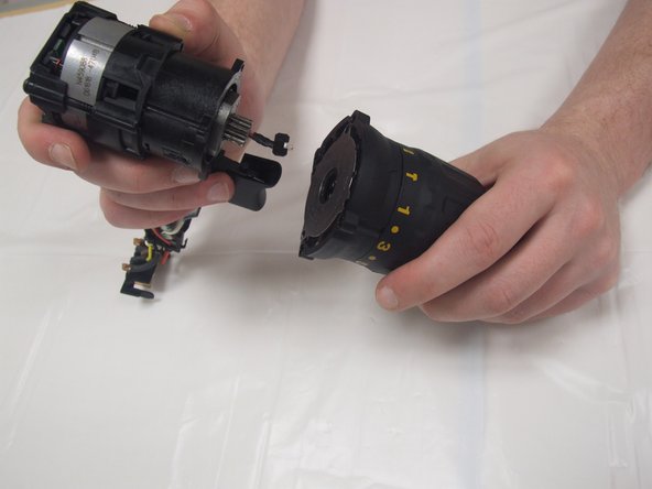

    1. Dewalt DCD778 Motor Replacement, Motor: crwdns2935265:04crwdnd2935265:01crwdnd2935265:02crwdne2935265:0 Dewalt DCD778 Motor Replacement, Motor: crwdns2935265:04crwdnd2935265:02crwdnd2935265:02crwdne2935265:0
      • Remove the eight 16 mm, Torx Security #15 screws.
    2. Dewalt DCD778 Motor Replacement: crwdns2935265:05crwdnd2935265:01crwdnd2935265:01crwdne2935265:0
      • Lay the drill on its side and gently lift the top half off it.
    3. Dewalt DCD778 Motor Replacement: crwdns2935265:06crwdnd2935265:01crwdnd2935265:01crwdne2935265:0
      • Lift the drill mechanism out of the shell.
      • Desolder the red and black wires from the motor.
    4. Dewalt DCD778 Motor Replacement: crwdns2935265:07crwdnd2935265:01crwdnd2935265:02crwdne2935265:0 Dewalt DCD778 Motor Replacement: crwdns2935265:07crwdnd2935265:02crwdnd2935265:02crwdne2935265:0
      • Slightly twist and pull motor away from the clutch.
    5. Dewalt DCD778 Motor Replacement: crwdns2935265:08crwdnd2935265:01crwdnd2935265:01crwdne2935265:0
      • When installing the replacement motor into the clutch make sure you correctly align the gears in order to assure that the motor is properly fitted to the clutch.
