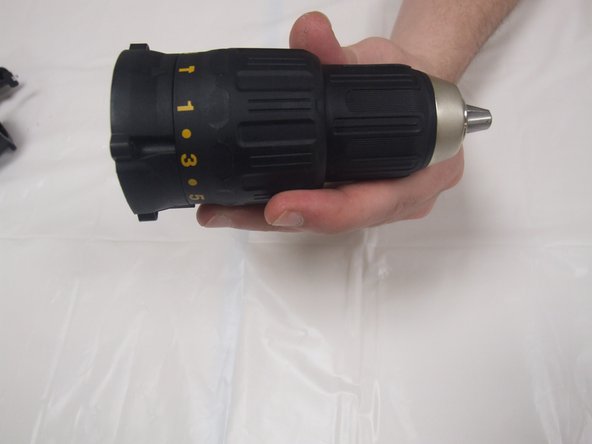

  4. Dewalt DCD778 Clutch  Replacement, Clutch: crwdns2935265:04crwdnd2935265:01crwdnd2935265:02crwdne2935265:0 Dewalt DCD778 Clutch  Replacement, Clutch: crwdns2935265:04crwdnd2935265:02crwdnd2935265:02crwdne2935265:0
    • Remove the eight 16 mm, Torx Security #15 screws.

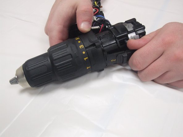

  7. Dewalt DCD778 Clutch  Replacement: crwdns2935265:07crwdnd2935265:01crwdnd2935265:03crwdne2935265:0 Dewalt DCD778 Clutch  Replacement: crwdns2935265:07crwdnd2935265:02crwdnd2935265:03crwdne2935265:0 Dewalt DCD778 Clutch  Replacement: crwdns2935265:07crwdnd2935265:03crwdnd2935265:03crwdne2935265:0
    • Twist slightly and pull clutch away from motor.
    • Remove clutch.
