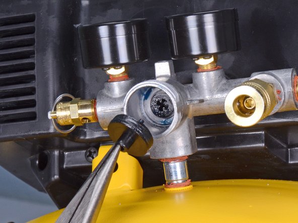

  4. Dewalt Air Compressor DWFP55126 2016 Regulator Rebuild, Remove regulator internals: crwdns2935265:04crwdnd2935265:01crwdnd2935265:03crwdne2935265:0 Dewalt Air Compressor DWFP55126 2016 Regulator Rebuild, Remove regulator internals: crwdns2935265:04crwdnd2935265:02crwdnd2935265:03crwdne2935265:0 Dewalt Air Compressor DWFP55126 2016 Regulator Rebuild, Remove regulator internals: crwdns2935265:04crwdnd2935265:03crwdnd2935265:03crwdne2935265:0
    • Use needle nose pliers to remove the fitting.
  5. Dewalt Air Compressor DWFP55126 2016 Regulator Rebuild: crwdns2935265:05crwdnd2935265:01crwdnd2935265:02crwdne2935265:0 Dewalt Air Compressor DWFP55126 2016 Regulator Rebuild: crwdns2935265:05crwdnd2935265:02crwdnd2935265:02crwdne2935265:0
    • Use a Phillips #1 screwdriver to unscrew the pressure regulator assembly from inside the manifold.
    • Use needle nose pliers to remove the regulator assembly.

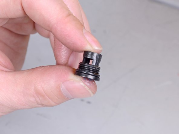

  6. Dewalt Air Compressor DWFP55126 2016 Regulator Rebuild, Assemble new regulator internals: crwdns2935265:06crwdnd2935265:01crwdnd2935265:02crwdne2935265:0 Dewalt Air Compressor DWFP55126 2016 Regulator Rebuild, Assemble new regulator internals: crwdns2935265:06crwdnd2935265:02crwdnd2935265:02crwdne2935265:0
    • The next three steps describe how to assemble the new regulator assembly.
    • Install the new o-ring on the new screw fitting by sliding it over the threads. Make sure it sits flush on the head of the screw fitting, directly above the threads.

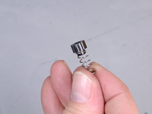

  7. Dewalt Air Compressor DWFP55126 2016 Regulator Rebuild: crwdns2935265:07crwdnd2935265:01crwdnd2935265:02crwdne2935265:0 Dewalt Air Compressor DWFP55126 2016 Regulator Rebuild: crwdns2935265:07crwdnd2935265:02crwdnd2935265:02crwdne2935265:0
    • Seat the narrow end of the new cap into one end of the new spring.

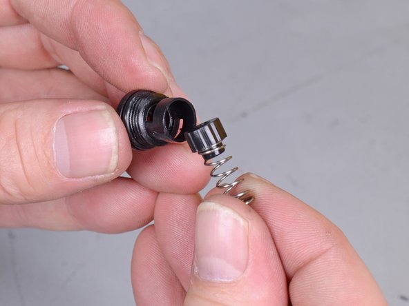

  8. Dewalt Air Compressor DWFP55126 2016 Regulator Rebuild: crwdns2935265:08crwdnd2935265:01crwdnd2935265:02crwdne2935265:0 Dewalt Air Compressor DWFP55126 2016 Regulator Rebuild: crwdns2935265:08crwdnd2935265:02crwdnd2935265:02crwdne2935265:0
    • Slide the cap and spring, cap first, into the opening on the screw fitting to complete the new regulator internals.
    • Reassembly tip: some of these components are not firmly attached to each other, so reinstall carefully, being sure everything lines up.
