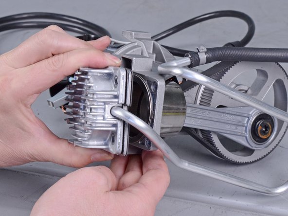

  14. Dewalt Air Compressor DWFP55126 2016 Control Rod Replacement, Remove cylinder head: crwdns2935265:014crwdnd2935265:01crwdnd2935265:01crwdne2935265:0
    • Use a 5/8 inch socket to remove the four cylinder head bolts.
  15. Dewalt Air Compressor DWFP55126 2016 Control Rod Replacement: crwdns2935265:015crwdnd2935265:01crwdnd2935265:02crwdne2935265:0 Dewalt Air Compressor DWFP55126 2016 Control Rod Replacement: crwdns2935265:015crwdnd2935265:02crwdnd2935265:02crwdne2935265:0
    • Pull the cylinder head off of the pump assembly.
    • The cylinder head gaskets can be very sharp around the edges. Wear gloves if you need to.

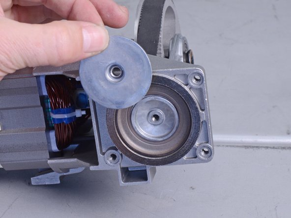

  17. Dewalt Air Compressor DWFP55126 2016 Control Rod Replacement: crwdns2935265:017crwdnd2935265:01crwdnd2935265:01crwdne2935265:0
    • Use a T20 driver to remove the piston screw.

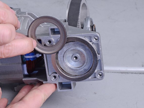

  18. Dewalt Air Compressor DWFP55126 2016 Control Rod Replacement: crwdns2935265:018crwdnd2935265:01crwdnd2935265:03crwdne2935265:0 Dewalt Air Compressor DWFP55126 2016 Control Rod Replacement: crwdns2935265:018crwdnd2935265:02crwdnd2935265:03crwdne2935265:0 Dewalt Air Compressor DWFP55126 2016 Control Rod Replacement: crwdns2935265:018crwdnd2935265:03crwdnd2935265:03crwdne2935265:0
    • Remove the top piston plate.
    • Remove the piston washer.

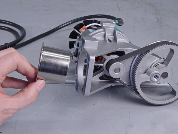

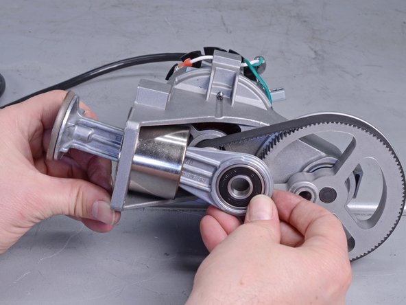

    • While holding the metal cylinder wall in place, push the control rod out to remove.
  20. Dewalt Air Compressor DWFP55126 2016 Control Rod Replacement: crwdns2935265:020crwdnd2935265:01crwdnd2935265:02crwdne2935265:0 Dewalt Air Compressor DWFP55126 2016 Control Rod Replacement: crwdns2935265:020crwdnd2935265:02crwdnd2935265:02crwdne2935265:0

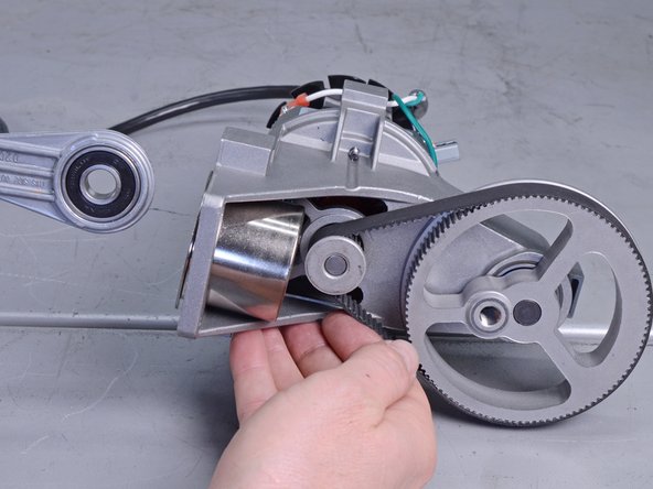

    • Remove the cylinder wall.
    • A new cylinder wall is included in the new control rod assembly.
