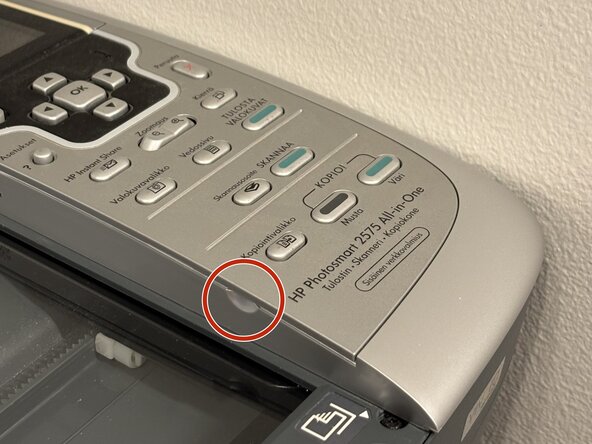

Detaching the HP Photosmart 2575 All-in-One's control panel
  1. Detaching the HP Photosmart 2575 All-in-One's control panel, Control Panel Faceplate: crwdns2935265:01crwdnd2935265:01crwdnd2935265:01crwdne2935265:0
    • Remove the control panel faceplate by lifting up at the notch.

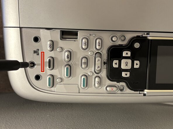

  2. Detaching the HP Photosmart 2575 All-in-One's control panel, Detach control panel (not wires): crwdns2935265:02crwdnd2935265:01crwdnd2935265:01crwdne2935265:0
    • Unscrew one T10 screw near the bottom of the control panel
    • Lift the control panel up at the bottom, around 5 mm above the machine and pull the panel towards the front of the machine.
    • Now you have access to the screws below the control panel. Note: I haven't been able to disconnect the flat flexible cable and the JST connector from the PCB.
