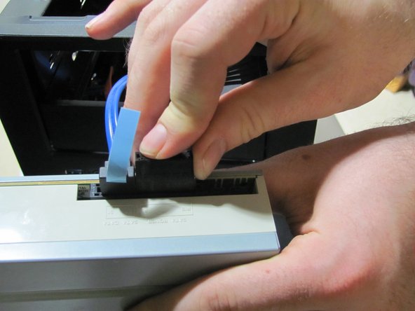

    • Locate the cables attached to the back of the CD drive.
    • Remove the cables. In order to do this gently but firmly grasp the cables and pull backwards.
    • I recommend marking the cords you unplug with a piece of tape so you can easily find them again later.
    • If the cables are unreachable, you may need to do the next two steps before this one.

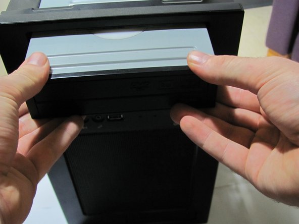

  7. Desktop PC CD Drive Replacement: crwdns2935265:07crwdnd2935265:01crwdnd2935265:01crwdne2935265:0
    • Slide CD drive out of the front of the case.

    • Get your new CD drive.
    • Pull the taped cables through the opening for the CD drive.
    • Remove the tape from the cables.
    • Plug the cables into the new CD drive.
    • Slide the new CD drive back into the front of the case.
