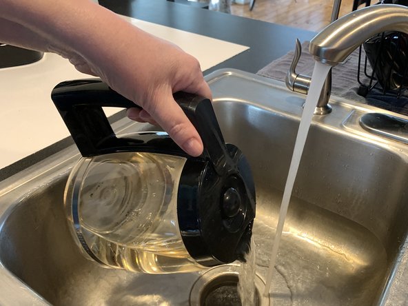

    • Fill the coffee maker's glass carafe with 6 cups of cold tap water and 6 cups of distilled white vinegar. Do not mix.

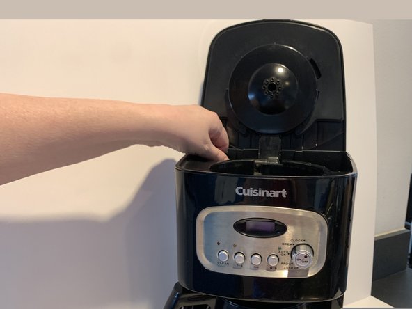

    • Remove the coffee filter holder from the coffee maker.

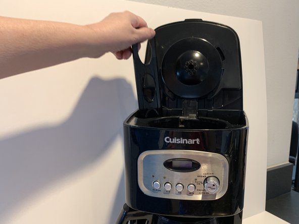

    • Pull the charcoal filter container out of the coffee maker and remove the filter pod. Wash and dry the filter container.

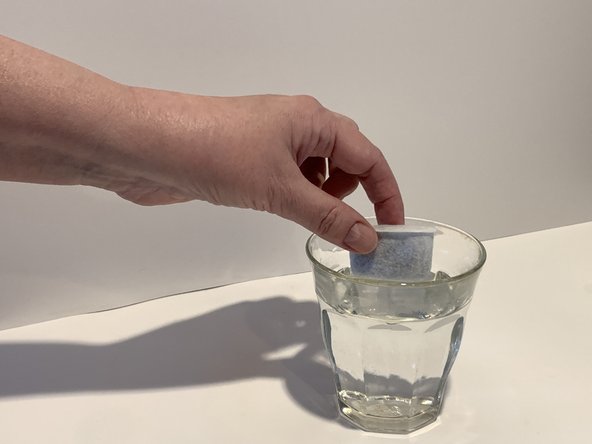

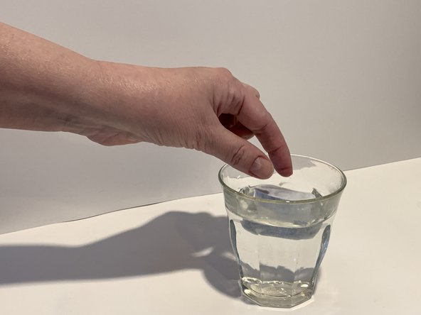

    • Place a new filter pod in 1 cup of cold tap water; allow it to soak for 15 minutes.

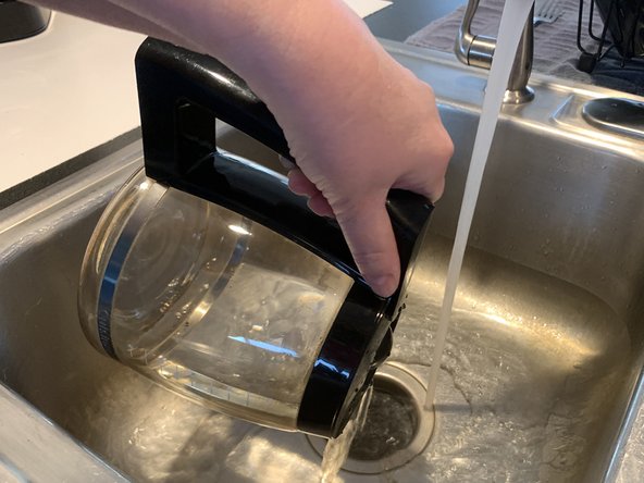

    • Pour the hot liquid down the sink drain while running cold water from the tap, so as not to damage the plumbing.
    • As an alternative, remove the carafe from the heat and allow the liquid to cool before pouring it down the drain.

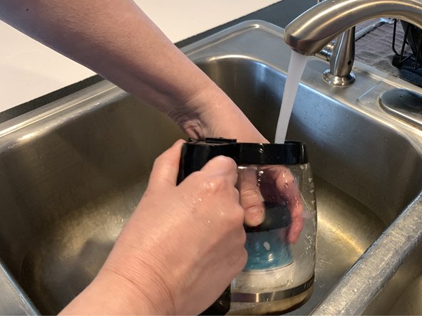

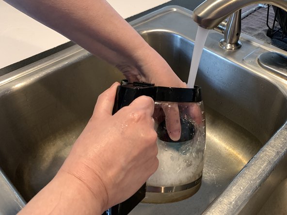

    • Wash the carafe with soap and water; dry it with a clean dish towel.

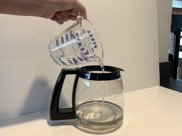

    • Fill the carafe with 12 cups of cold tap water.
  10. Descaling a Cuisinart 12-Cup Coffee Maker: crwdns2935265:010crwdnd2935265:01crwdnd2935265:03crwdne2935265:0 Descaling a Cuisinart 12-Cup Coffee Maker: crwdns2935265:010crwdnd2935265:02crwdnd2935265:03crwdne2935265:0 Descaling a Cuisinart 12-Cup Coffee Maker: crwdns2935265:010crwdnd2935265:03crwdnd2935265:03crwdne2935265:0

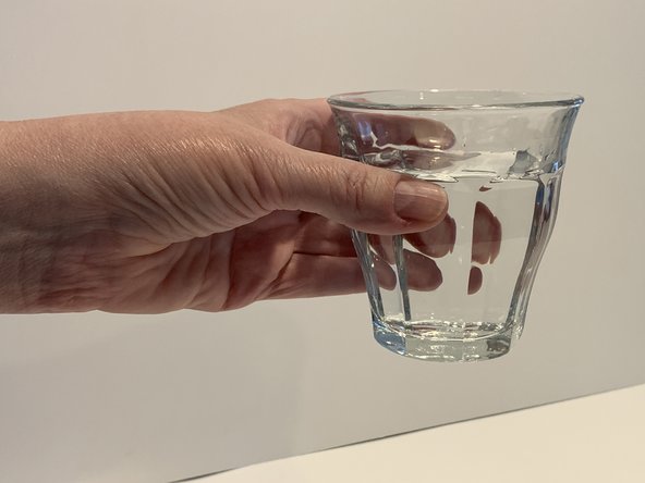

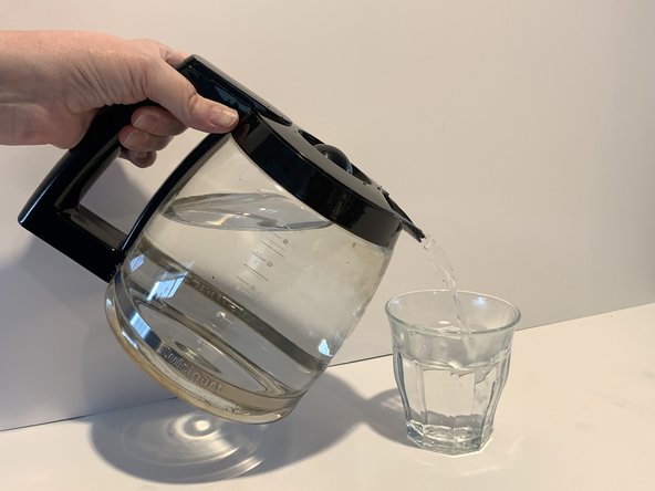

    • Repeat the process of pouring the water into the reservoir, completing the brew cycle, and pouring the water down the drain. Reserve 1 cup of the water.
    • Allow the water to cool, then taste it and see if any vinegar flavor can be detected.
    • If any vinegar flavor can be detected, repeat the process and taste the water again until no vinegar flavor can be detected.

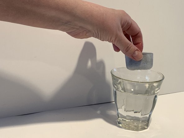

    • Remove the filter pod; discard the water.
